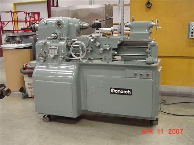

One of the reasons I got into CNC was I had a good machinist friend who encouraged me to put all of my manual machining activity aside and focus on getting my CNC mill up and running. His argument was that I would be so much more productive with the CNC that it was the most important productivity thing I could do for my shop. It didn't take me long after getting the mill up and running to realize that he was exactly right. The most compelling argument for me in favor of manual is the cost argument. That, and I've got a bit of nostalgia for amazing old manual machines like the Monarch 10EE I have pictured. But if budget was no object, I'd set up a shop entirely with CNC machines. In fact, even if budget was an object, depending on the type of work I needed to do and the volume, CNC would still be my first choice.
