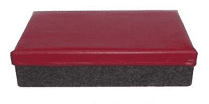

Surface Plate Covers
If your surface plate is not in continuous use (most are in commercial shops), it's nice to protect it with a fitted cover:
