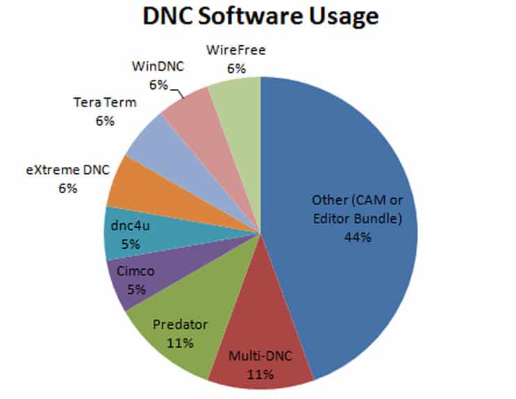

Which DNC Software is Everyone Using?
Like most of the other software categories we have surveyed, the DNC software market is very fragmented. Here are the market shares for the survey:
It’s pretty fragmented with most shops using DNC software that came with their CAM or Editor.
