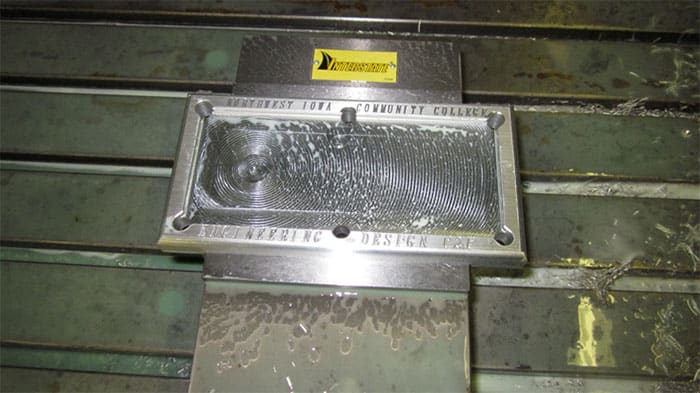

Top being machined using a 3 flute with B-CAD adaptive roughing...

Bottom machined with a 1/2" 3 flute and used a 3/8" ball endmill to create the angled slots for ball return...
