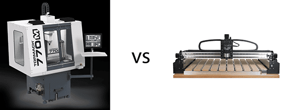

Two different types of CNC machines, one with large enclosed body and "YAMAZAKI" logo.

The Shapeoko CNC Router is a typical entry-level CNC Router while the Tormachs are the typical entry-level CNC Milling Machines. In general, CNC Routers are going to be cheaper than CNC Mills at a given level of capability.  When we start talking about the very best CNC Routers, they cost more than the entry-level milling machine, but less than the very best CNC Mills.
