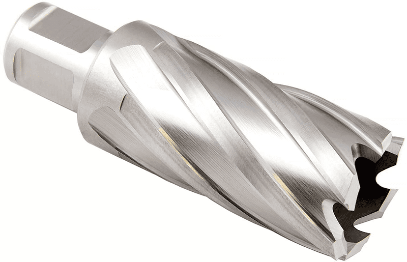

An annular cutter (also called a Rotabroach, core drill, core cutter, broach cutter, trepanning drill, hole saw, or cup-type cutter) is a special type of cutter for making holes.  It is similar to a hole saw for cutting metal.  What's unique about an annular cutter versus many other holemaking solutions is it only cuts a groove at the periphery of the hole, which creates a solid slug that is removed from the center of the hole.

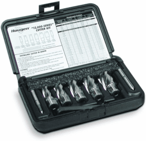

Note that all three of the other approaches are significantly faster than interpolation.  Also, annular cutters are relatively inexpensive.  You can buy them in annular cutter sets that include a variety of sizes to get started:
Compact black plastic case containing Hougen 12,000-SERIES drill bits.
A nice Hougen set goes for about $168 on Amazon...

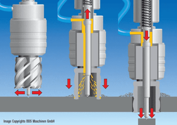

Annular cutters are set up with a Weldon-style shank and are intended to be used with set screw holders or chucks set up to engage the flats.  In addition, they have a central pin that ejects the slug.  The pin is called a "Pilot Pin" or "Ejector Pin".
As the cutter goes down into the hole, the pin rests on top of the slug.  A stop in the machine will eventually push against the pin and eject the slug as you continue retracting.  Some designs include a spring to inject the slug so they can work on an unmodified machine.  On some models, the pin also controls whether cutting fluid is dispensed.
Here's a diagram of the ejector pin in action:
An illustration of a drill bit in a metalworking process.
Annular cutter ejector pin operation.  Image courtesy of BDS Machinen GmbH...
So, you need a machine that's set up to do that ejection to use an annular cutter.

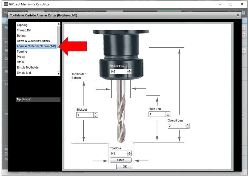

As with all cutters, you want to operate annular cutters at the proper feeds and speeds for best tool life and optimal performance.  Our G-Wizard Feeds and Speeds Calculator makes that easy, because it supports annular cutters.  Just choose them on the Tool menu and go from there:
Machining tool menu with Annular Cutter (Rotabroach) and tapping options.
