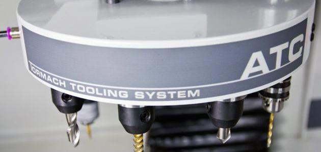

Tormach Automatic Tool Changer...
Tormach themselves are constantly improving the machines. My PCNC 1100 is a "Series Three". So far, Tormach has a great track record of making it fairly economical to keep older machines upgraded to the latest factory spec. That shows a tremendous commitment to the installed base and it's not something every company will do.

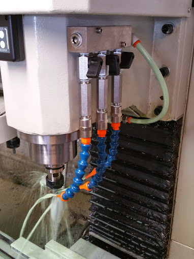

Coolant Nozzle Upgrade
John's also coming out with this sweet multi-nozzle upgrade to the Tormach flood coolant system:
Installation is very sanitary and compatible with the stock system. Looks sharp and works great!

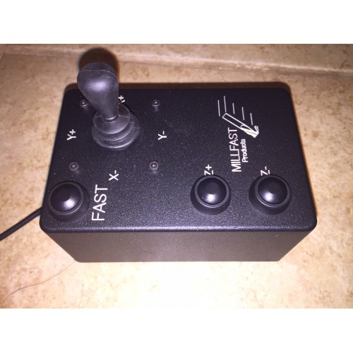

Millfast Products: Electronic Accessories Such as Joysticks for Tormach
Fancy a Joystick instead of Tormach's default Jog Shuttle? Millfast has got you covered!
They have a variety of cool accessories including, joysticks, remote e-stops, and more. I purchased the little gizmo that lets you keep both a probe and an electronic toolsetter connected at the same time. Works great!

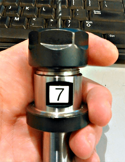

Engrave a serial number on your toolholders to refer to in the tool table...
Labeled toolholders are handy for all sorts of things. If engraving them is not your fancy, try stick on labels:
This label was done with a Dymo XTL 300 Industrial Label Maker Kit. The labels are supposed to be pretty darned coolant-proof. You can get one for less than $300 from Amazon.

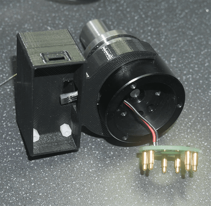

This is a very cool mod by David Loomes on the Tormach Facebook group.
Probe disassembled...
3D printed clip on enclosure for wireless electronics...

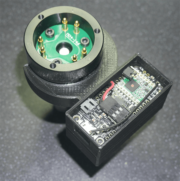

Enclosure clipped on and probe contact leads fed through...
Probe PC Board reinstalled, Adafruit transmitter module installed, and probe PC board back in probe...
Battery pack is underneath...
Ready to probe!
More info:
No, I'm not concerned with latency. I've measured it at a fraction under 9.5ms and it's consistent to sub microsecond levels. I generally do the 2nd probe at 25mm/min, so the positional error represented by the latency is just 0.00015". Not only is that way below the repeatability of the probe, but it's know and consistent. I expect it will result in a small reduction in the probe tip diameter as determined by any of the usual calibration methods and nothing else.
