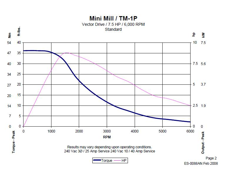

What the heck just happened? My friend, you're a victim of an unruly spindle power curve. Your spindle doesn't have the full 8.5 HP available at every rpm. In fact, for most rpms, it has much less. Here is the power curve for the Haas TM-1, for example:
The pink line shows how peaky this spindle's power curve is....
Follow the pink curve over to 5194 rpm and we can see that the power is way down here. You don't have nearly the 5+ HP that the cut calls for.
This is not an uncommon situation. If your machine tool doesn't have more than one speed, you're relying on your VFD to carry you across an extremely broad rpm range. Even if you do have more than one speed, if you take a look at the power curve for your spindle, it's probably at least a little bit peaky. You won't find the full power everywhere.
I got to looking into this after a G-Wizard trial user complained that every single recommendation they'd gotten from GW had stalled their spindle. Turns out the had the little Haas mill. I was surprised to hear about this problem, and got to poking around for a while before I figured out the problem was the issue of trying to get aggressive when you're too far away from the power peak. It's almost a forgone conclusion you're going to be there at some point. For example, aluminum loves more rpms, and this particular power curve drops all the way down to 2.5 HP if you max it out at 6000 rpm.

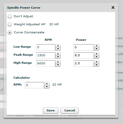

In order to help machinists manage this problem, the latest release of G-Wizard (1.600) adds the ability to specify a Power Curve Adjustment. The screen for it is accessed via an "Adjust" button next to the Hardware Profile Spindle HP on the Setup tab. If you press it, you'll get this popup:
The Power Curve Popup programmed for the Haas curve...
As you can see, I've set it up with the numbers for the Haas. Here's how it works. First, there are 3 adjustment options:
- No Adjustment: Just use the peak at all rpms.
- Weight Adjusted: This is for very small mills, things like Sherlines and Taigs. GW takes the work envelope and the machine weight and de-rates the spindle power as necessary to compensate for the relative lack of stiffness on these machines.
- Curve Compensate: This is the one we want to help out our little Haas.
The curve is set up in anticipation of a peak. Think of the peak as a "V" shape. The Low Range is where you specify the rpm and power at the low end of the band. On the Haas chart, it shows 0 HP at 0 RPM, and that's what we specified for the low end of the "V". The Peak Range is where you specify your spindle's power peak. For the Haas, I read it as 1500 rpm, 8.5 HP. Lastly, the High Range is the right leg of the peak. Again, the Haas looks like it is showing 2.5 HP at a peak of 6000 rpm.

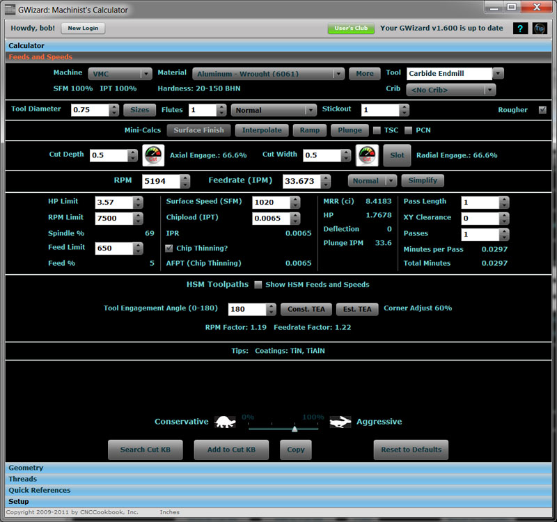

That's all there is to it. GW will then interpolate along that curve and use that as the HP limit for the particular rpm in use. Here is a screen shot of G-Wizard under these circumstances:
Power curve adjusted feeds and speeds...
What G-Wizard did was to set the HP Limit based on the power curve and the rpm (5194 rpm is what was requested). If the required HP is higher than the limit, it automatically scales back the feedrate until it gets an HP that falls within the limits again. It doesn't compute a precise intersection, but leaves a little "fudge" room as these curves are not precise. It's trying to be a tad conservative. You're welcome to crank it back up a touch if you're sure your spindle won't stall.
