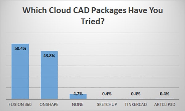

Which Cloud CAD Packages have you tried?
Responses are nearly evenly split between Fusion 360 and Onshape…
The responses are nearly evenly split between Fusion 360 and Onshape. I also tallied how many had tried both F360 and Onshape and that number was about half, which is excellent. Our audience has considerable familiarity with both products.

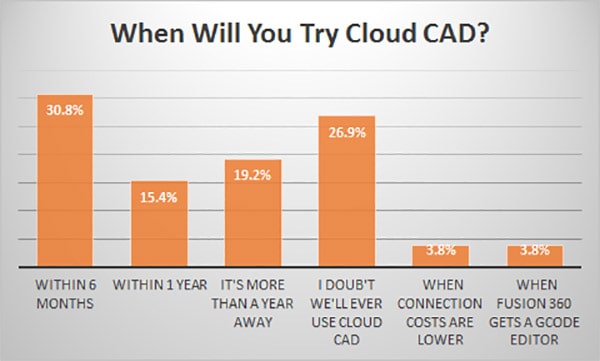

If you haven’t tried a Cloud CAD package, when do you plan to try one?
As I said, the wording of the survey discourages those who have never tried Cloud CAD, but we did get about a 15% response that had never tried it. Here is their response about when they expect to try Cloud CAD:
Nearly half expect to try Cloud CAD in the next year or less, so it is definitely top of mind. A few are down to try it much further out, and a vocal minority says “Never.” There were two that gave some reasoning about their time frame. In one case, they wanted connection costs to be lower and in the other they wanted Fusion 360 to include a GCode Editor/Simulator so they could check their gcode before running it on a machine. Given that we make a product for that purpose (G-Wizard Editor), it’s certainly a practice we recommend and a very common use people have for the product.

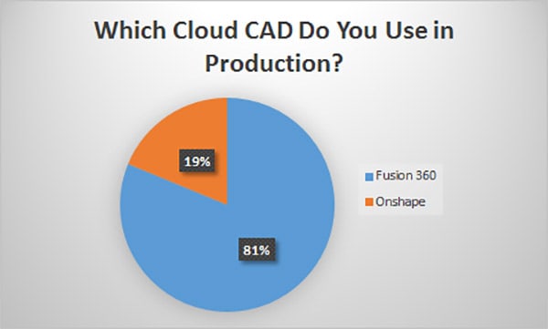

Which Cloud CAD Packages are you using in Production?
This is a very pivotal question–just because you tried Cloud CAD doesn’t mean you liked it. The numbers were really good here, though. Out of the audience that had tried Cloud CAD, 41% of them had decided to go ahead and use the package in production. That shows very solid support for the concept rather than folks just dabbling around. We’ll get to some of the things holding people back from adoption shortly, but most are entirely correctable by the vendors and likely already on their road maps.
Here’s the breakdown on which Cloud CAD Packages are actually being used in production:
Surprisingly strong adoption of Fusion 360 for production…
I was surprised to see how much stronger the production support was for Fusion 360 than Onshape. I will have more to say about why I think it is, but for now, let’s just say Autodesk was smart to have built such a fine CAM package into Fusion 360 from the get go.

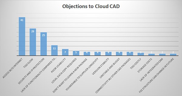

What are your biggest objections to Cloud CAD?
I really wanted to understand the objections to Cloud CAD, given that the Cloud is a major paradigm shift that has swept much of the software world and is currently hitting the CAD world. Here are the objections from the folks who have actually used it, which for me are more valuable than all the theoretical objections one often hears. I actually asked this in two different ways using a second question, “What’s holding you back from Cloud CAD?” to double check and get the highest possible data quality in the responses. Here’s what you told us:
Top Objections to Cloud CAD…
The Top 3 objections stand way above the others:
- I need access without the Internet. This was expressed in many ways:
- “I can’t start a new job without uploading”
- “My DSL has been down for a full day 3 times this year. I can’t afford to stop work that long.”
- “Our Internet is too slow”
- “I want to be able to look through local files fast and only upload in background when I go to edit them.”
- “It takes too long to load local files into the Internet”
- And many more…
- Cloud CAD is Too Slow! This looks to be very dependent on the quality of the Internet connection. There was some complaint about overall “feel” being too slow, but a much more common complaint was file uploads were just too slow.
- Security and IP Protection. Another very common issue. Folks were concerned about what could happen if the Cloud CAD vendor was hacked, especially when the system was used overseas.

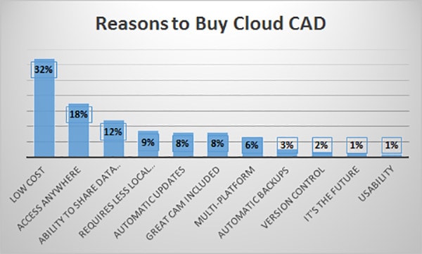

What Attracts You to Cloud CAD?
Objections are all very well, but let’s face it, the absence of negatives doesn’t create success. People need good positive reasons to buy. Here’s what you said were the positive reasons to buy Cloud CAD:
Realtors are fond of saying that what makes a house valuable is, “Location, location, location.”
For Cloud CAD, it is “Price, price, price.” Low cost was cited as a reason to buy close to 2x the next closest reason.
Access Anywhere was the next most popular. This meant a variety of things to people based on comments, but the gist of it was:
- People are tired of having to buy multiple licenses for multiple machines or deal with dongles. The license needs to be tied to them and they need to be able to login to a variety of machines. We believe strongly in this at CNCCookbook too.
- Machines are distributed all over. Keeping them in sync with thumb drives and the like is too painful. The Cloud makes it easy. Sit down at a machine, login, and everything you need is right there.
- CNC’ers that have to travel to clients are worse, overseas, really love this Access Anywhere capability.
Data Sharing and Collaboration was next, and the last big response. Businesses that have to collaborate value this capability. Also mentioned was how handy these features are when it comes time to sell yourself to a new prospect.
Requires Less Local Hardware. This one was fascinating. CNC’ers like being able to use their crappy old hardware with Cloud Software. Or, even if it isn’t old, it may not be a high dollar CAD Workstation. It might even be something very low end like a Chromebook as several mentioned. They don’t hope to run high quality desktop CAD on such machines but seem quite content to run their Cloud CAD there. So many selected this that together with the additional color provided by comments, it was made clear that any performance objections to Cloud were largely around file upload times and the quality of the Internet connection.
Automatic Updates. Love ’em or hate ’em, and there are plenty in both camps, they matter. If you love to get the latest innovations and bug fixes quick–they’re a great idea. If the vendor is not careful about releasing buggy versions, you’re not going to like this. Given the responses, I would say both Autodesk and Onshape are doing a good job showing their audiences continuous improvement.
Great CAM Included. This one is clearly a thumbs up for Fusion 360. While it looks low relative to the rest, consider that it’s rank doubles when you consider only those who have tried Fusion 360. I will break it down by product shortly, but you get the idea.
Multi-platform. The most common refrain here was, “I want to run it on my Mac.” Only a few mentioned running on phones or tablets.
Automatic Backups. Here is another Love It/Hate It. Many worry about the security of their data. But for those who have lost data even though they were backing up, they want to be able to trust in a third party to do a better job backing up. BTW, this doesn’t release vendors for the desire many expressed to be able to keep a local copy as well.
Version Control. Definitely something gained here. These vendors have worked hard and customers indicate they’re doing a good job in this area. One bit of color is that both vendors got complaints that the overall user experience managing lots of files is still not as good or easy as managing folders on a local machine. This is totally fixable, but is an area the vendors need to keep after.
It’s the Future. This was a sentiment that I saw expressed by several who took time to comment on it. Clearly the handwriting is one the wall–Cloud is here to stay. As one fellow put it, “Seems like it’s the future whether we want it or not, so why fight it?”
