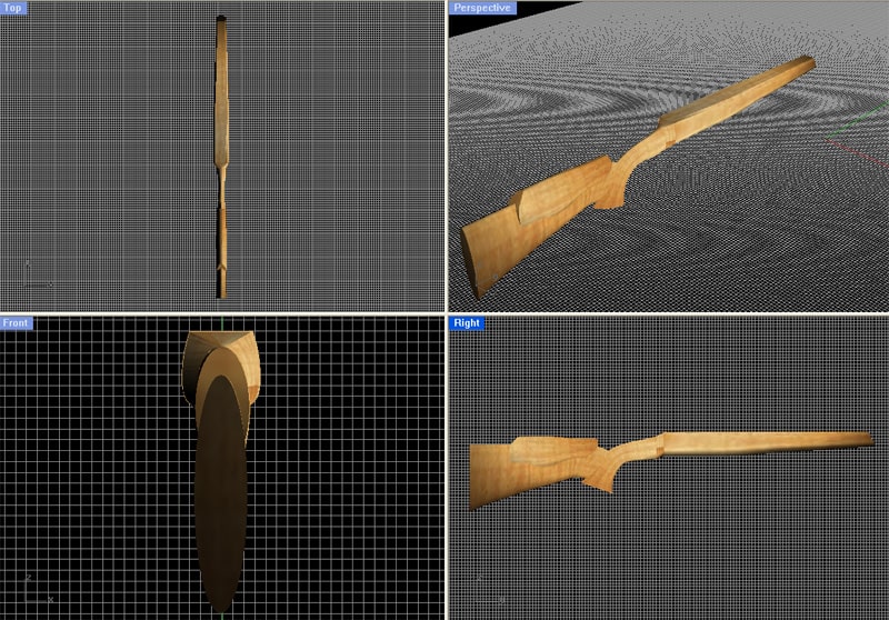

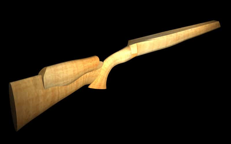

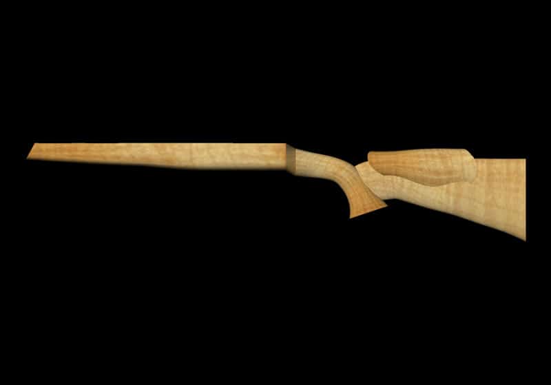

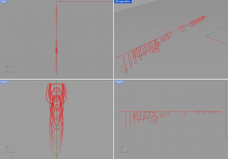

Experiments in Rhino 3D: Making a Rifle Stock Plans
Start With Some Profile Curves...

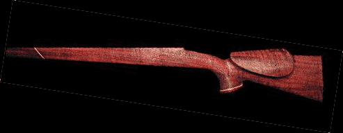

Loft, Cap Planar Holes, Minor Fine Tuning, and Voila, a Rifle Stock in Maple!

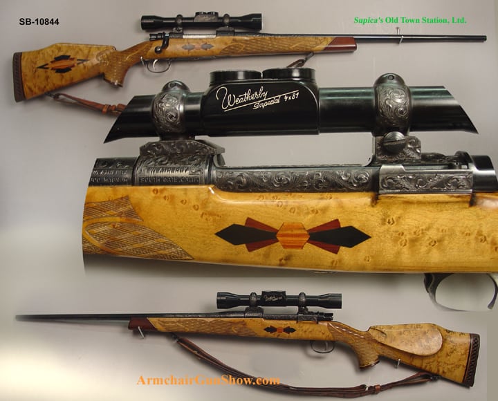

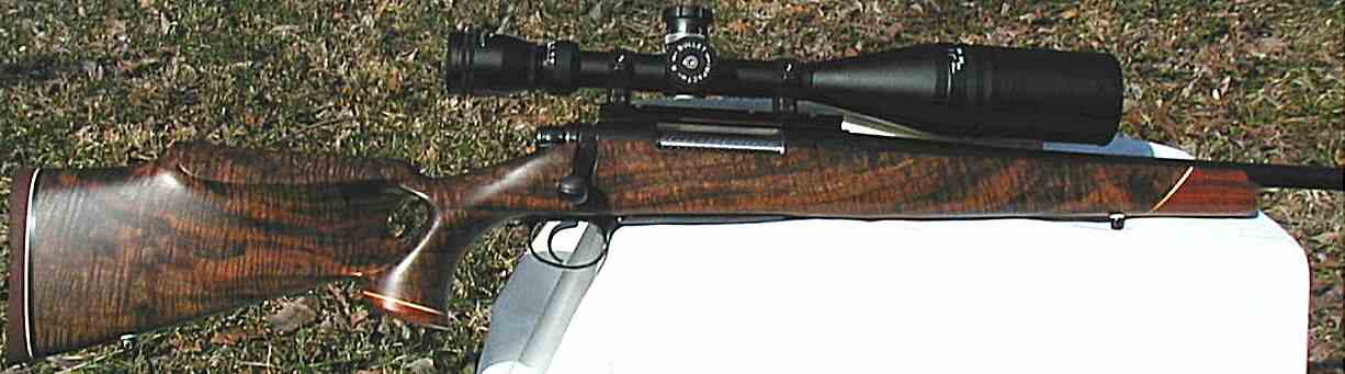

DIY Rifle Stock Photo Ideas from the Web

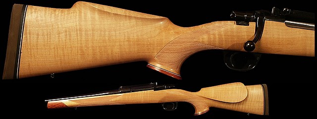

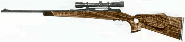

Fiddleback Maple with a Mauser action...

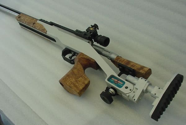

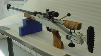

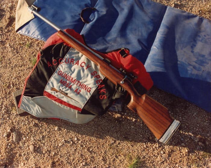

Ross Precision

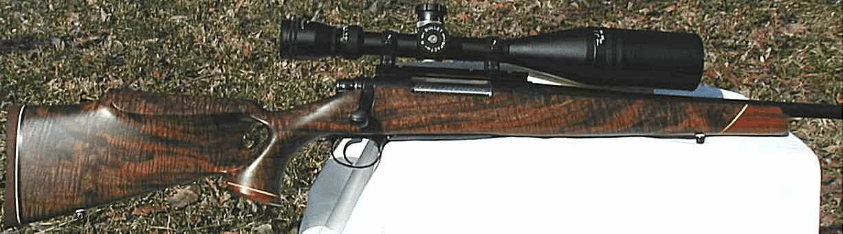

An interesting "machinist's" rifle.

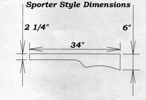

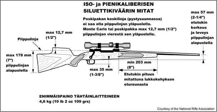

Rifle Stock Templates & Dimensions
The "pull" is the length from trigger center to butt plate, and is usually 13 1/2" to 13 3/4"...

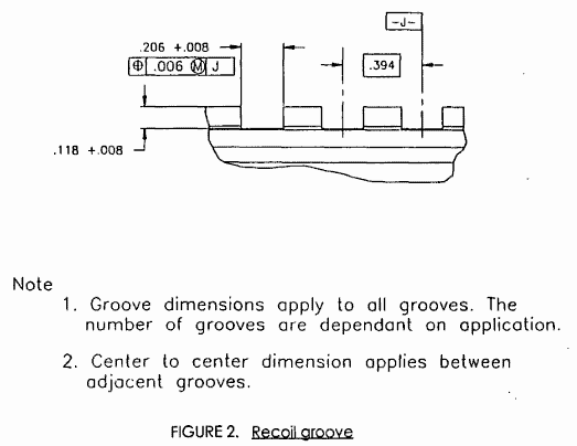

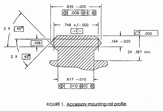

Picatinny Rail Dimensions
