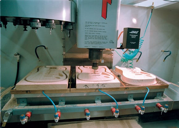

Or, how about Fender's custom guitar shop? There could hardly be a more iconic name in guitars, but they've definitely been successful applying VMC's to their work:
Making Fender electric guitar bodies on a Haas VMC. Note the vacuum fixtures!

- Make sure the ballscrew and waycovers will provide adequate protection against the wood dust. There'll be no liquid coolant to keep the dust down and it'll go everywhere it can.
- Look for high speed spindle options. Life begins at 10,000 rpm with wood and more is better. Take a look at the CNC Router crowd to get an idea.
- Make sure you're set for higher feed rates. With those high spindle rpms, high feed rates are not far behind.
- To keep up, you may want to check into higher block per second processing options for your machine. It isn't just the high rpms and feedrates, if you plan to do flowing organic curves, these will often be simulated as thousands of short line segments. Your control will have to keep up with many blocks per second to keep that G-code flowing smoothly into motion. While we're on that subject, get plenty of RAM so you can keep large 3D profiling part programs in memory.
- If tolerances are going to be tight, look for climate control in your facility to help minimize shrinking and expansion in the wood you'll be machining. I wonder whether some RAMTIC-style in-process probing might not also be an answer to tolerances in a material like wood that won't sit still.
- You won't be using liquid coolant, but you can use a chip auger and you'll also want to make provision to vacuum out the machines from time to time to keep the dust under control.
- Wood, especially plywood and thin veneers, can splinter or tear out. Learn the best techniques for CNC machining plywood and similar materials to prevent splintering.
