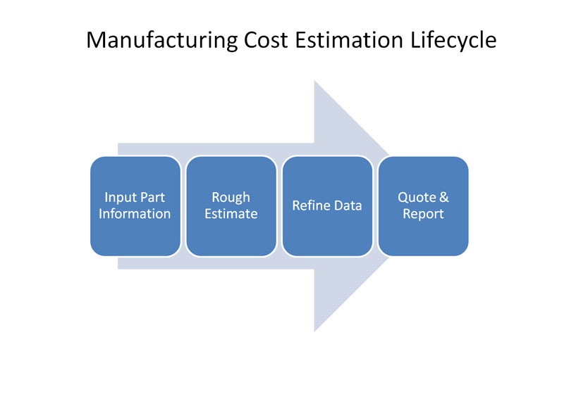

Cost Estimation Lifecycle
We can look at the various stages involved in producing a Quote and then consider the Automation benefits and issues associated with each:
Let's take this Lifecycle in order. First, we need to tell the Cost Estimation Software enough about the part that it can create a rough estimate. Depending on the Cost Estimation Algorithm (more on that later), it can take quite a lot of information before a Rough Estimate can emerge:

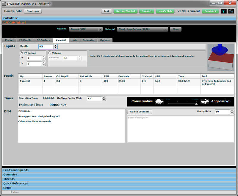

A step up would be to generate a Feature-Based Cost Estimation using a tool like our CADCAM Estimator. This tool fixes the rekeying problem, and in conjunction with the CADCAM Wizards, it greatly simplifies creation of a Cost Estimate Spreadsheet. For example, here is the CADCAM Wizard for Face Milling:
Just tell it the depth of the material to be removed and the X and Y extents and it will work up the rest of the estimate for the operation including Feeds and Speeds calculation and time required to complete the operation. It even has a feature called "DFM" (Design for Manufacturing) that makes suggestions for changes that would make the part cheaper to manufacture.
Notice there's also an "Add to Estimate" button. This is the connection to the CADCAM Estimator module:

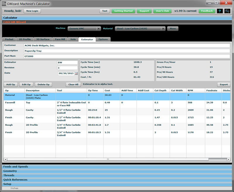

By selecting different features in the CADCAM Wizards, letting the Wizard do the estimate for the feature, and then adding the feature to the overall estimate, a spreadsheet is built up row by row and with minimal effort. When you've finished building the estimate, press the "Export" button to export a spreadsheet containing the estimate.
At that point, you have a set of very high quality data on which to base your estimate. What's left is largely packaging. If you have existing Cost Estimation Software rather than spreadsheets, you could also import this data into your software to feed estimates.
