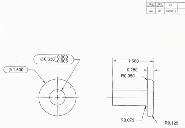

I recently got a call from a customer who wanted to see a demo of how to estimate lathe parts. I suggested he send me a print for one and I'd do a video. Here's the print he sent:
Print for a simple turned part...
It's a pretty simple part with just a few features. Features are specific aspects of the part that are created using a CAM operation. For example, this part has the following features:
- 2 diameters-one is 1.660 and one is 0.630.
- 3 facing operations
- 3 specified radii, each of which is a feature
G-Wizard Estimator works by making it easy to key in features from a print and see a final estimate of costs. Here's the video I made showing how to estimate this part:
