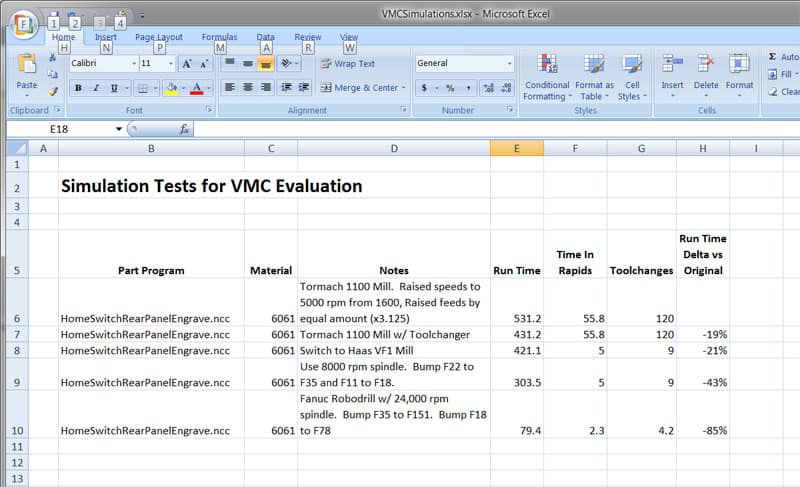

I just put together a very simple comparison spreadsheet in Excel that looked like this:
As you can see, I track what each scenario consists of in terms of part program, material, what I changed from one to the next, resulting simulated run time, time in rapids, time in tool changes, and the % overall run time versus the original. Depending on what you're trying to figure out, a number of other columns might make sense.

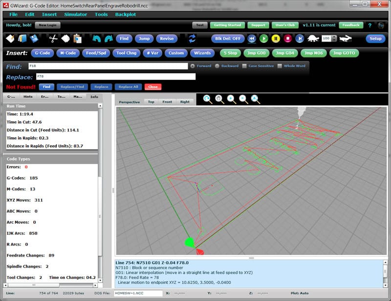

Step 5: Run the Simulations
To run the simulations, I used the GW Editor's Find/Replace function to update the Feeds and Speeds in the program, I put the correct machine profile in place, then I went over to the Info tab and recorded the results in the spreadsheet. The Info Tab collects all sorts of information about the running characteristics of the simulated part program:

The spreadsheet tells the story of this particular set of scenarios. Adding a toolchanger to the Tormach saved almost 20%. Switching to the Haas VF-1 got us another 20% without updating the program largely due to faster rapids. Updating for the VF-1's base 8K rpm spindle got us to a more substantial 43% savings-almost twice as fast. The Robodrill's 24K rpm spindle really sings, though, as it manages an 85% savings in cycle time.
None of this is to say that any of these machines is better than the other-these are just the results of one particular set of scenarios. For example, there are materials that have to be cut slowly enough we couldn't take advantage of the 24K rpm spindle option on the Robodrill. Perhaps they can't run the spindle any faster than the Tormach's, but these difficult materials might require more rigidity. What you've got to do to make a business decision is build a good set of representative scenarios for your shop or project, plug in the cost information, and then see how long it would take to pay for the investment in better machinery.
