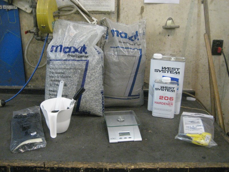

First thing is that epoxy resin generates a cumulative allergic reaction. You don't want it on your skin, so wear rubber gloves!
Here's what my West Marine resin looks like along with some odds and ends to help out:
Resin, Hardener, Metering Pumps, Disposable Mixing Cups, Postal Scale, etc. We're making toxic mud pies here people.
The West Marine pumps are cool. Each pump meters the right proportion of the critical
fluid so you don't have to worry about it. The instructions say you can
leave the pumps on even in storage and worst case is you may have to clear
a nozzle of gummy liquid. The pumps worked great: wouldn't want to be
without!

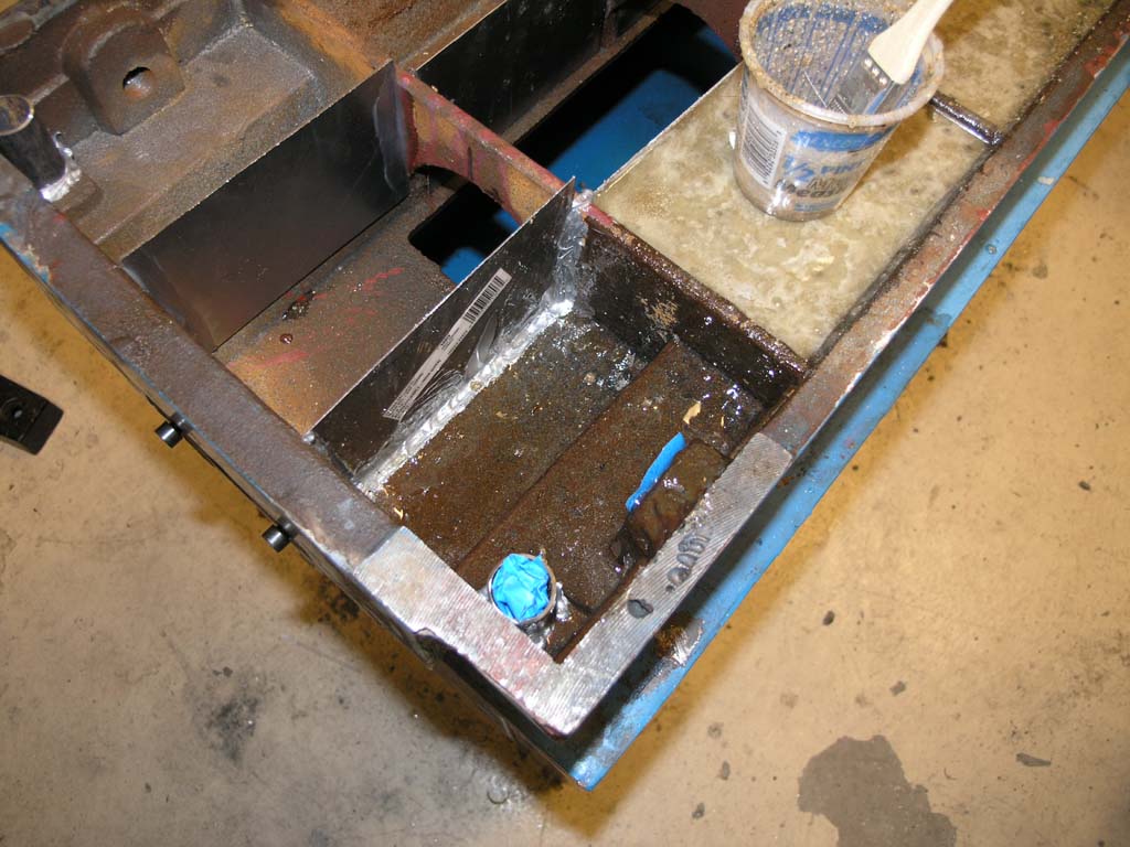

Okay, let's begin filling the base. We've got all the dams built. Here's how I go about it:
First, I mix up a little batch of epoxy. Those pumps make it dead simple: 2 pumps resin,
2 pumps hardener, mix well with the chip brush. Note the two bays already
filled have cured overnight and are lookin' good!
Next I like to paint all the surfaces with the first batch of epoxy. I want the epoxy
to bind really well to the metal. Cross linkages from this layer back
into the aggregate will ensure things are really tied together well...
Now I quit taking pictures because I was juggling!

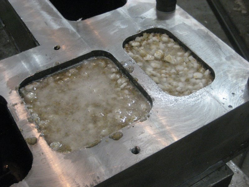

You can do the work in layers, so long as the layer you pour on top of hasn't set up the epoxy can still form good cross linkages. According to West Marine, you're good even after things appear to be hard so long as you can still get an impression from your thumbnail on the epoxy. I don't let it get even close to that. The way I work is I mix aggregate and epoxy in the little cup, but too wet. I stir it well with the chip brush to make sure everything is well coated. Then I pour that into the base. Next I put on a layer of dry material without additional epoxy. I know my ratios, so I'm not just doing this by eye. When I stir that into the wet layer, I get a consistency like peanut butter and everything is well coated. I'll go like this for a couple cup fulls, and then watch it for two or three minutes. Usually some liquid epoxy rises to the surface. That's when I add a layer of glass bead media on top:
The glass beads are very fine, so they'll fit into the holes between the sand and gravel. More stirring until it's all well coated, and I will have a lot less epoxy on top. So I go to another layer. Eventually, I get to the top of the bay:

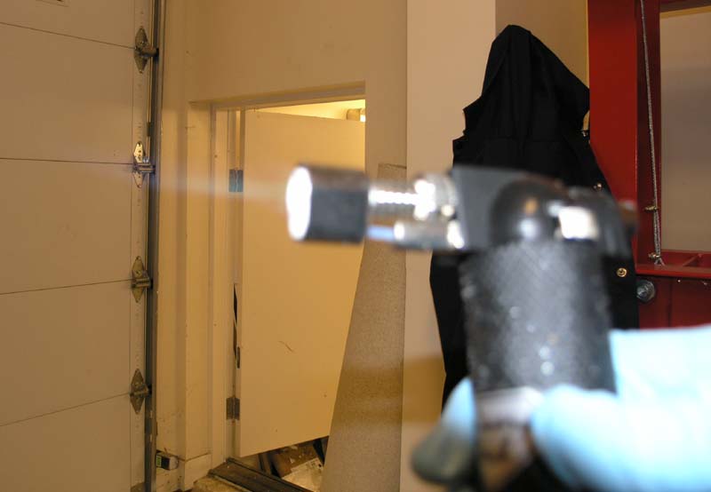

See all those nasty air bubbles? I like to get rid of them...
This lousy out-of-focus pic is of a little push to light butane torch that is perfect for bubble
busting. Play it slowly over the surface and the bubbles disappear quickly!
Leaving me with something more like this. I could've add more sand or glass beads, but
I'm concerned about overflowing, so I stopped. Another bay is complete!
Working like this, I made it all the way around, and filled all the bays except the
center column hole and the 2 bays where the 4 column bolts come in. The
whole casting is considerably heavier, and when tapped with a hammer,
sounds a lot more solid and less "ringey"...
My concern at this stage is whether the pipes that protect the column bolt holes from
epoxy are really epoxy tight. I had a couple leaks in the rest of the
bays. Nothing major, but it would have been enough to gum up the works
terribly if even a little epoxy ran down those column bolt holes!
Accordingly, I am going to insert the bolts into each hole just a short ways...
And then I will fill until I am above the casting line with wax from a candle. The wax
will harden and keep the epoxy out. When the epoxy has set, I can heat
up the wax and melt most of it out. The bolts can cut any remaining wax
that gets in the way very easily. At least that's the theory. We'll see!

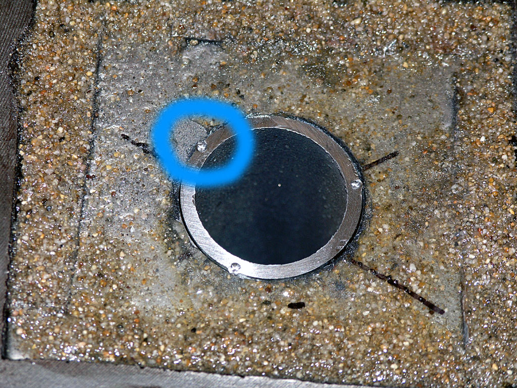

Next I made a plate to fit the center column hole which goes all the way through.
I've got a piece of PVC pipe that will serve as the channel for my big
1 1/8" column bolt. I've just applied copious amounts of epoxy to
the edges to seal it up. Thicker epoxy would've been better for the purpose,
but this is what I had on hand...
Just finished filling and still need to go over it with the blowtorch to pop the bubbles...
A view of the whole thing. Column hole is still drying but the other wells are set...
Once that had set, I flipped the base over with help from my brother and poured the
small top cavity above the metal plate. The base now weighs close to 200
lbs! It is markedly "deader".
Here you can see I trimmed the PVC liner for the big central bolt hole that will help
anchor the column...
Looking good! Next step for the base is a set of leveling feet...

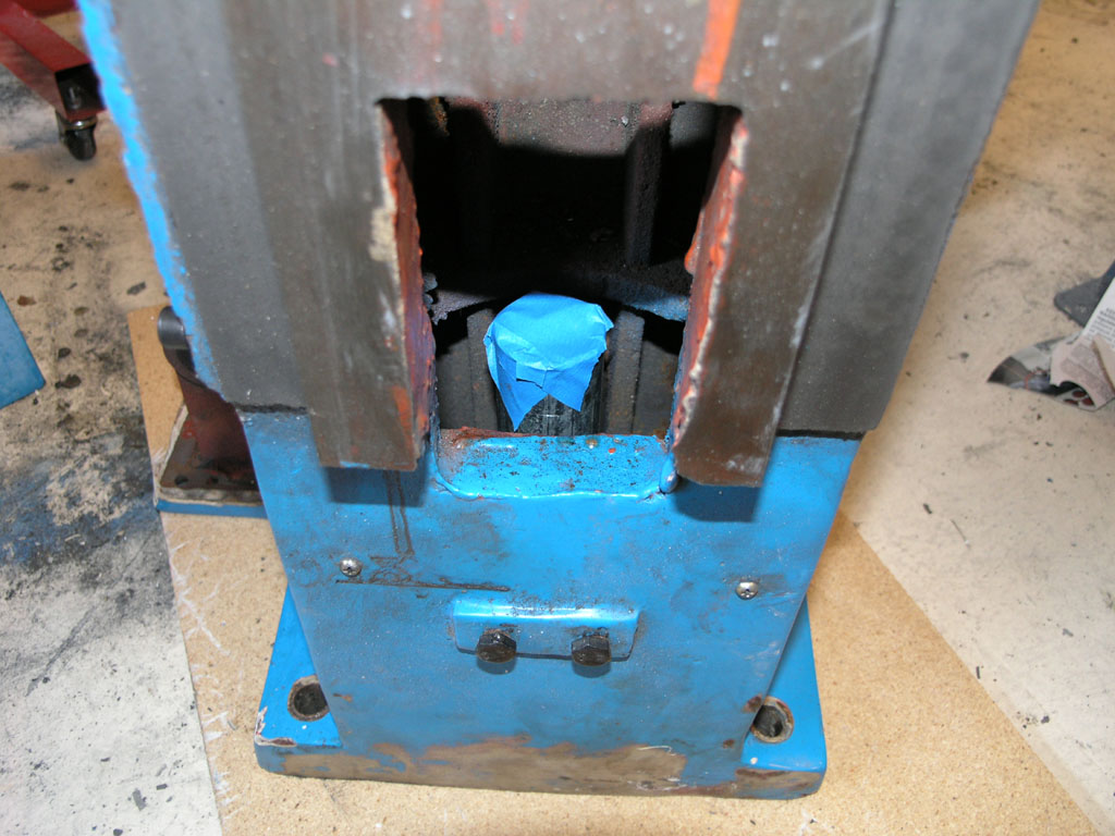

On to the Column Fill: First We Need a Column for the Central Bolt
First step was to epoxy a thin metal plate into the opening in the base so it would seal. The casting was really rough, so I used epoxy with sand to fill in the edges until I got the plate solidly mounted and with no discernible leakage. This was a big improvement over the silicone cement I had used earlier.
After the epoxy for the plate had dried I took a hole saw for the pipe the bolt will pass
through. Note that I used a pipe quite a bit larger than the PVC on the
base so there is plenty of clearance. This greatly simplifies alignment
and there's still plenty of beef. The pipe was kind of an off-size, so
I used a 1 5/8" hole saw and then a drum sanding cartridge to make
it a nice sliding fit.
To hold the pipe in position I used a punch to dimple the edges in 3 places. That's
how close the fit was. I made sure to level the pipe so it was vertical
and then I applied some more epixy around the edges.

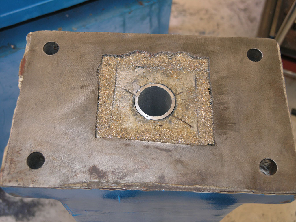

The surface tension works nicely to let me apply a fair amount of epoxy. I just want enough to hold the pipe solidly so that when I flip the column over start adding the E/G mixture from above it won't break loose. I'll let this cure all week and then tackle the fill next weekend. I've decided not to fill the column all the way up. This arrangement will fill the bottom 10" or so and should add considerable dampening without in any way being a clearance problem. I would think this will really help the mill to perform better to have this much added dampening mass in the critical junction between the base and the column. More would be better, but I'm anxious to get on with the rest of the CNC conversion and there is a lot of work to do!
With the pipe and bottom plate secured, I flipped the column up on end and masked off
the top of the pipe...
Filling the cavity through the narrow slot was easiest with a cheap ice cream scoop
I bought at the hardware store for $4...
I filled up to about 1/2" from the top of the pipe, and then I switched to a
pure sand mixture to make sure the top was free of rock edges sticking
up...

That came out looking very professional!
I checked back some time later with Davo727 via PM, and he is still very pleased with this mod on his mill.
FYI, his mix consisted of:
17 lb Sand = 26%
38 lb Gravel = 58%
10 lb Epoxy = 15%
Other Fills

Raw materials...
