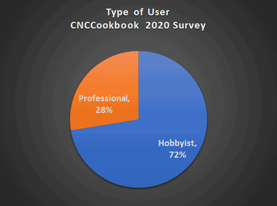

Hobby vs Pro Users
Our 2020 results are identical to the mix from 2017, 72% Hobbyist and 28% Professional.

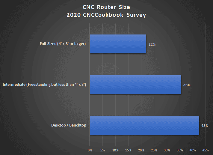

CNC Router Size
First up is size of the work area. Here are the trends since 2017:
- Desktop was 48% and is now 43%. People are buying or building larger routers.
- Intermediate was 30% and is now 36%. Looks like Intermediate is the category that folks have moved up to.
- Full Sized was 21% and is now 22%. The share is about the same.

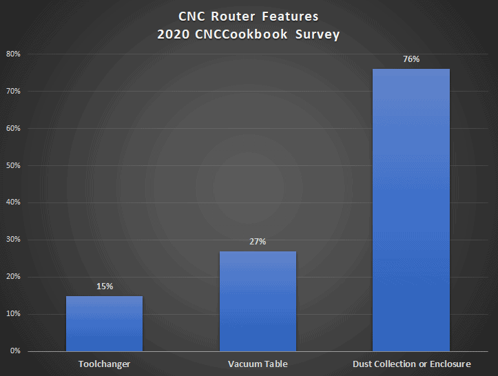

CNC Router Features
As before, we surveyed to see how many had these premium features on their CNC Routers:
- Dust Collection or Enclosure was most popular, and actually increased from 71% to 76%. Routers can sure make a mess without a little help!
- Vacuum Tables are a very handy way to hold down the work. They’re up slightly from 25% to 27%
- Tool Changers are a professional productivity feature, but they are hard to come by. Share is down slightly from 16% to 15%. I wonder when we’ll see a breakthrough in the lower range of the market with someone introducing a toolchanger at a good price on a popular machine?

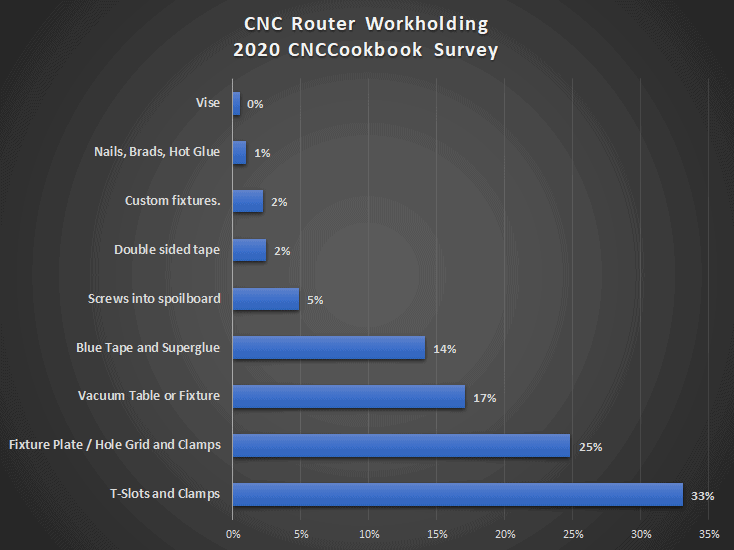

This is a new category this year. It tracks what form of workholding is most popular among CNC Router users.
At 58%, the most popular by far are clamps that attach to either threaded holes or T-Slots.
The clamps are followed by Vacuum Tables or Fixtures, Blue Tape & Superglue, or screwing directly into the spoilboard. A few listed custom fixtures. One of the most interesting was a fixture to allow mounting a board vertically for cutting dovetail joints.

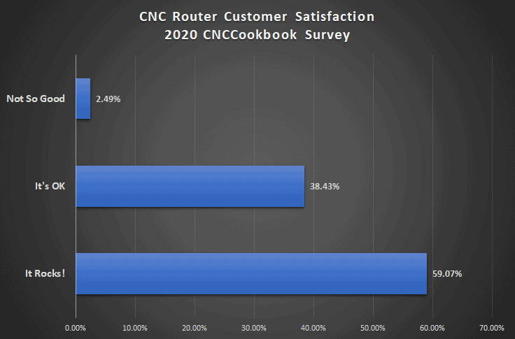

Overall Customer Satisfaction is up compared to what it was in 2017 when it was already high. In particular, having 59% of folks giving their CNC Router highest marks (It Rocks!) is awesome. That number was 55% back in 2017, so the machines have only gotten better.
The “Not So Good” rating went from 5% down to 2.5%.

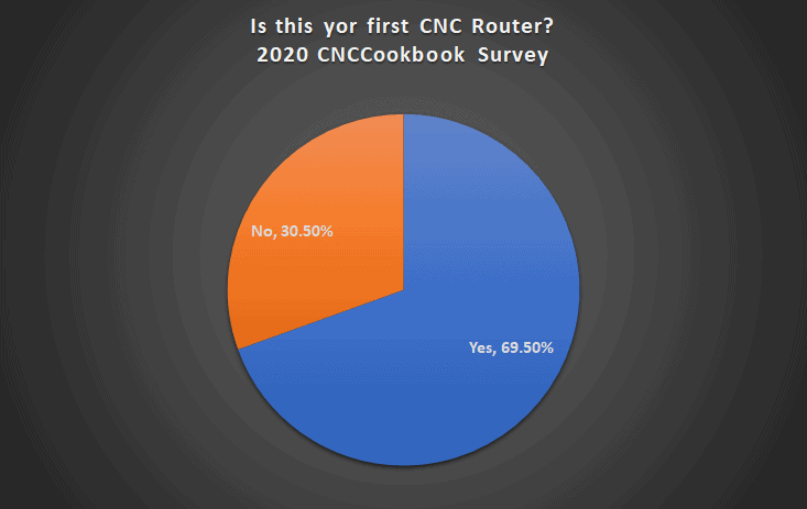

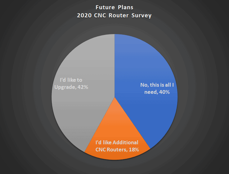

I asked a couple of questions in the survey to determine where respondents are in their journey.
About 30% of respondents had owned other CNC Routers in the past.
In terms of Future Purchases, 40% say they have all they need, 18% would like additional CNC Routers, and 42% would like to upgrade to a better router.

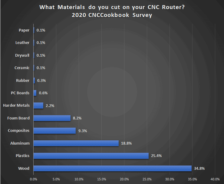

It’s always interesting to see how CNC machines are used.
For the most part, respondents are cutting Wood, Plastics, and to a lesser extent aluminum on their CNC Routers.
Cutting Aluminum on a CNC Router does take a bit of skill and special techniques, but it’s good to see many respondents are pulling it off.

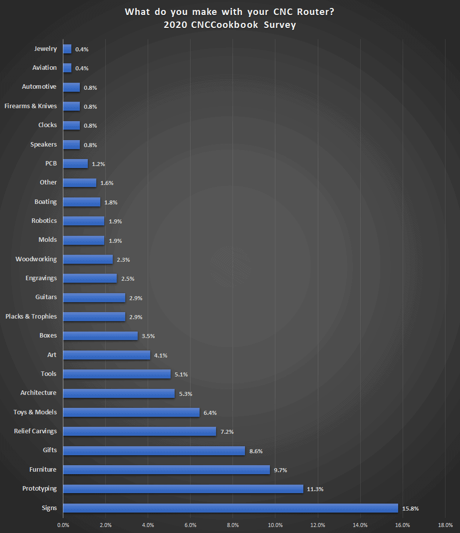

As for what folks are making on their CNC Routers, here’s what they said:
Some of these need a little interpretation:
- Prototyping: Many said “repair parts”, “we make everything”, or “parts for products we manufacture”. Those all landed here. Consider it to be generic parts.
- Furniture and Architecture: Cabinets went to both. Architecture could include architectural details like decorative mouldings or anything that would become physically part of a building.
- Relief Carvings were also referred to as 3D Carvings by many. Same thing.
- Toys & Models was everything from children’s toys, to games, to scale models of various kinds.
- Tools includes anything tooling or shop storage related. A lot of these involved jigs and fixtures used for making other things.
- Boxes also includes generic inlay work.
- Guitars is mostly guitars but there are a few other music-related things that went here.
- Woodworking was both people calling out things as “woodworking projects” and miscellaneous woodworking that didn’t go elsewhere.
