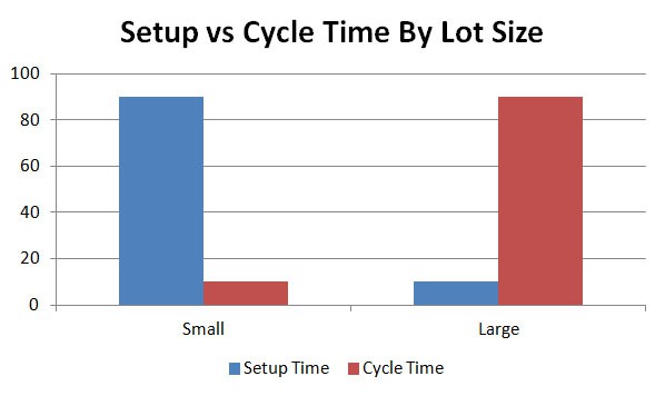

Until you have that essential data (and it is very important to get real data for your shop), you can rely on some basic principles. For example, the relative amount of time spent on Setup vs Cycle Time is often a function of your lot size. How many of each particular part are you producing? If you produce very few of a wide variety of parts, you spend the majority of time setting up and tearing down for the next job. If you produce huge numbers of very few parts, you may leave a setup in place for days at a time and only feed in more work material and fresh cutting tools. Lot sizes result in this sort of trade off for Cycle Time vs Setup Time:
For very small lot sizes, you might spend 90% of the time on Setup activities and only 10% on running the machine. For very large lot sizes, it's reversed: 10% on Setup and 90% on Cycle time.
What we can conclude from this is that it's very important to know the relative amount of time spent on each type of activity. Small lot size businesses benefit most from reductions in Setup time while large lot size businesses benefit most from reductions in Cycle time. That's not to say both businesses don't benefit from either kind of reduction, but you want to focus your energies where the most productivity gains are to be had.

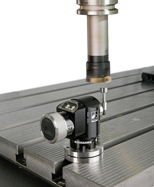

Well, you can move some of that Setup Time into the machine's Cycle Time. Consider the Setup Time for cutting tools. You need to get the Tool Length Offsets loaded for each job. Offline Tool Setting is great if the machine is busy, busy, busy, but not so hot if the machine is sitting idle. But, if you equip it with the necessary touchsetter, you can just stick tools in the changer and program the machine to figure out the offsets using the Touchsetter. Here is a typical tool setter:
Note how the probe is set up-we can both measure tool length by dropping down onto the probe tip, as well as diameter. Typically, the tool is spun in reverse at a slow speed while the measurement is being made. The reverse spin is so the tool doesn't cut the tool setter, and the rotation itself ensures the measurement of the lowest hanging insert or cutter tooth.
This is great. Your operator no longer has to measure the offsets and load them into the Tool Tables. The machine takes care of that itself.
