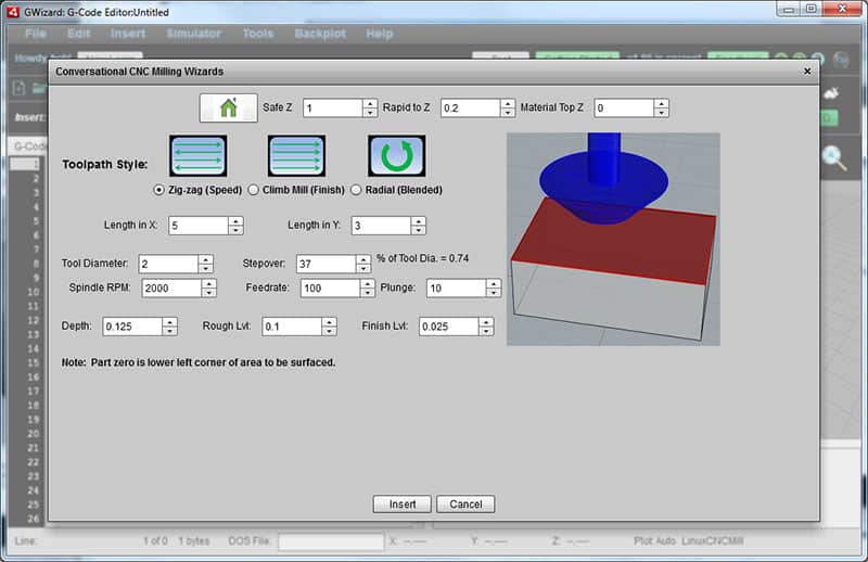

Here are the parameters needed by the Surfacing (Face Milling) Wizard from G-Wizard Editor:
Conversational CNC Milling Wizard toolpath style interface with Zig-zag Speed settings.
The parameters that must be specified are:
1. Toolpath Style. A graphical icon shows how the face mill will travel across the surface.
2. Safe Z: Z height where the cutter may move at full rapids speed in any direction without hitting anything.
3. Rapid to Z: Z height where the cutter may move at full rapids speed in Z only directly over the cut.
4. Material Top Z: Z height where the cutter will encounter the workpiece. Most CNC'ers like to use 0.
5. Length in X: Length of the area to be surfaced along X axis.
6. Length in Y: Length of the area to be surfaced along Y axis.
7. Tool Diameter: The diameter of the tool that wiill be used.
8. Stepvoer: % of Tool diameter to step over for each pass.
9. Spindle RPM & Feedrate: The Feeds and Speeds to use.
10. Plunge: Feedrate to use for the final plunge down onto the workpiece to start cutting.
11. Rough Lvl: The depth of cut when roughing.
12. Finish Lvl: The depth of cut for the finish pass. The total depth of cut will be Rough Lvl + Finish Lvl
These are all pretty simple questions that are easily answered, even by beginners. To figure out the Feeds and Speeds, our free Milling Speeds and Feeds Calculator can help.
