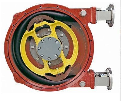

The biggest problem with a Barbot is how to measure out the drink ingredients.  You need a way to meter multiple ingredients (15 in Bartendro’s most complex and expensive incarnation) that is food safe and easily cleaned.  I’ve seen Barbots with various tipping mechanisms that try to pour the alcohol from a bottle the way a human bartender would.  I’ve also seen them that use a valve that is opened for a specific time interval.  Bartendro uses what is probably the most commercial efficient mechanism–an array of peristaltic pumps.  Here’s a shot of a really high capacity peristaltic pump that shows the mechanism off well:
A peristaltic pump with a red outer casing and a yellow and black inner mechanism.
The concept is simple.  There is a length of tubing around the circumference.  Rotating the pump activates a cam action that pinches off part of the tubing.  The distance between the cams causes a “slug” of liquid to move through the tubing twice per revolution.  The volume of the “slug” is the unit of measure the pump is capable of dispensing.  It’s ingeniously simple, and the tubing is easily cleaned by running a fluid through it or replaced periodically as well.  It looks to me like it would be relatively easy to machine a little peristaltic pump.  You’ll need a bank of them, as well as some way to control their motion, to complete a Barbot of your own.  Or, you could sign up on Kickstarter for Bartendro–around $2000 for the 15 ingredient version.

You can buy peristaltic pumps pretty cheaply as mentioned above, or you could build those too.   After all, you are a CNC'er.  Here's a good photo of one just so you can see how they work:
As the rotor spins, it pinches a section of flexible tubing that pumps that amount of fluid into the outlet.  Pretty foolproof, and if you use food safe tubing, you're good to go.
