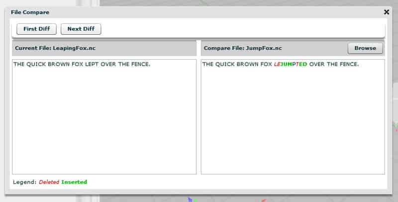

1. File Compare: When there's too many versions of the same g-code program running around.
Ever wonder what was changed between two versions of the same g-code program? Now it's easy to tell. Just load the latest version and then go to the File menu and select the "File Compare" command. It has a spot to load the older version. Now you can see what changed side by side:
Whether your fox jumped or lept over the fence, the difference will be there in color for you...

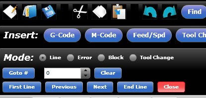

3. Jump To Bar
CNC g-code is full of context and modes. What's happening with the line you're on is often a function of something that took place in a prior line. Certain things are a nuisance to track down with Find/Replace, and for those things, we made the "Jump to" Bar. Like Find/Replace, it's not a popup. It goes on the tool bar like this:
The Jump To Bar...
The Jump To Bar is good for taking you to a particular line, line 100 for example, which may not be the line with "N100" on it. It can take you line by line to each line that has an Error (although you can see that on the Hints tab too). It'll take you to a particular "N" (Block) number or to the 3rd Tool Change. All in a day's work for the Jump To Bar.

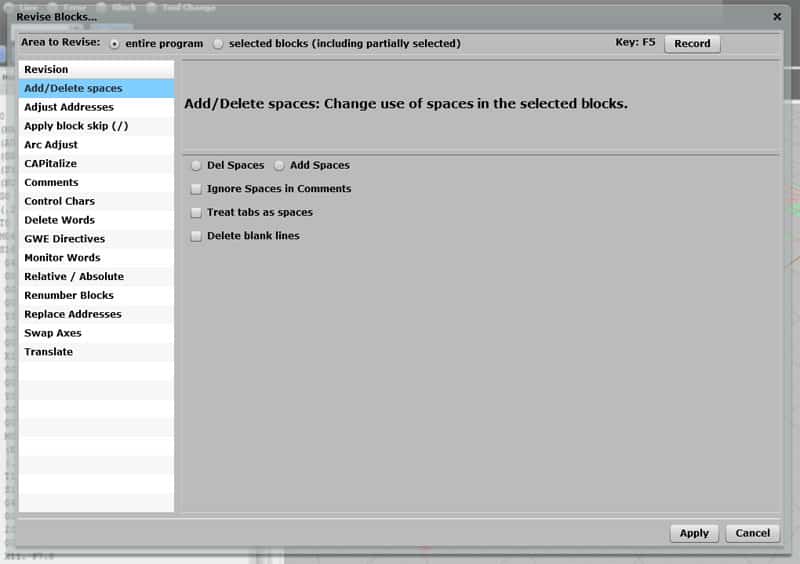

11. Revisions
What if you had an expert g-code program at your beck and call and he worked for free? You could use him to do all sorts of revisions on your g-code. That's what GWE's Revisions are for. They make special changes to your g-code-either the whole program, or a range of blocks you mark with the mouse. There's a whole bunch of different Revisions available from the Tools menu:

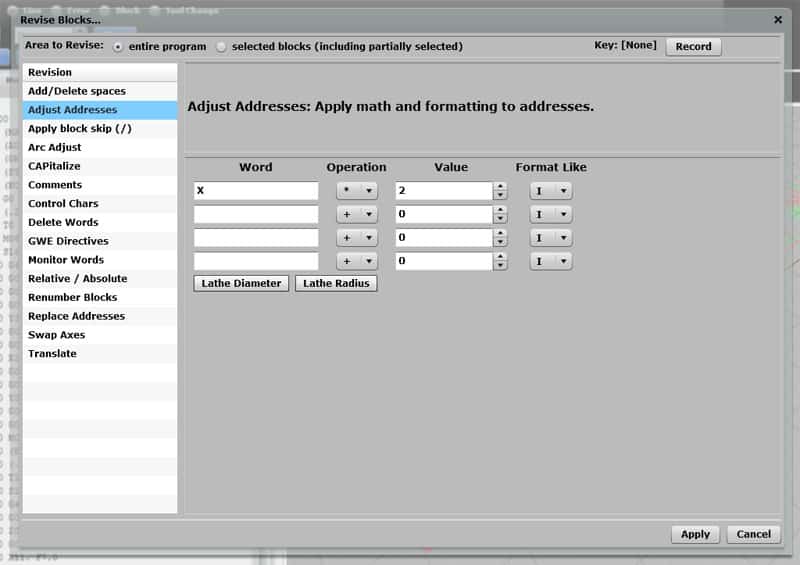

12. Convert to Lathe Diameter or Radius mode with “Adjust Addresses” revision
Let's try a quick revision. Say you've got a bunch of lathe g-code you're supposed to take over and manage. The guy that wrote it had everything in radius mode, but you find diameter mode to be much more intuitive. Piece of cake. Use the "Adjust Addresses" revision to change that code to your way of thinking:
You see what that's doing, right? It grabs ever X-word, multiplies by 2, then saves it back. Easy-peazy!

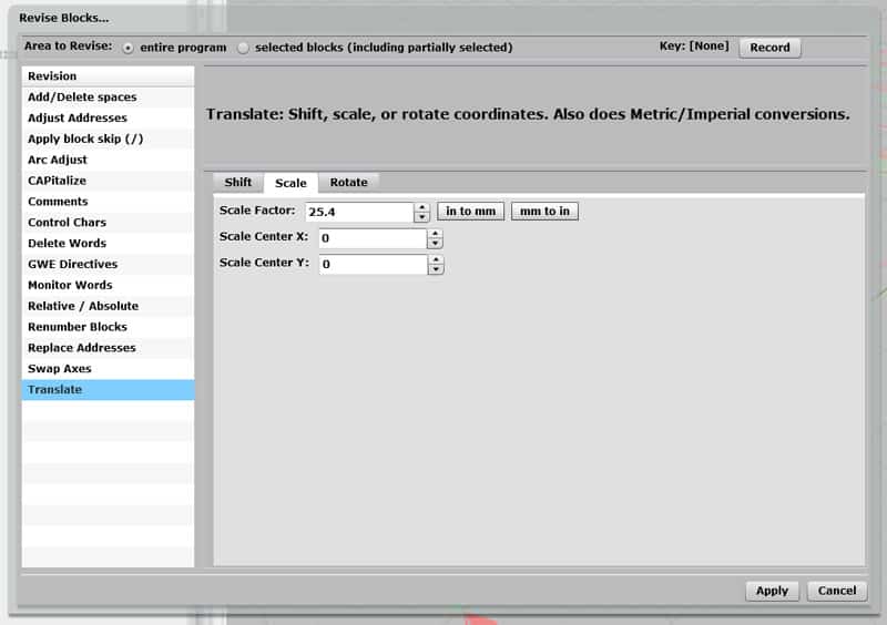

16. Convert to Metric or Imperial
They it's a Global Economy. That just means that like it or not, we will have to deal with the Other Guy's units sooner or later. Guess what? We got another neato Revision to make Unit Conversions easy:
17. Assign a Hot Key to a Revision
Notice that the Translate Revision pictured directly above has a little spot in the top right corner labelled "Key." That's a handy little doo-dad!
Press Record then press the key you'd like to tie that Revision to. Now you've got your own custom Keyboard Shortcut. Power to the People!

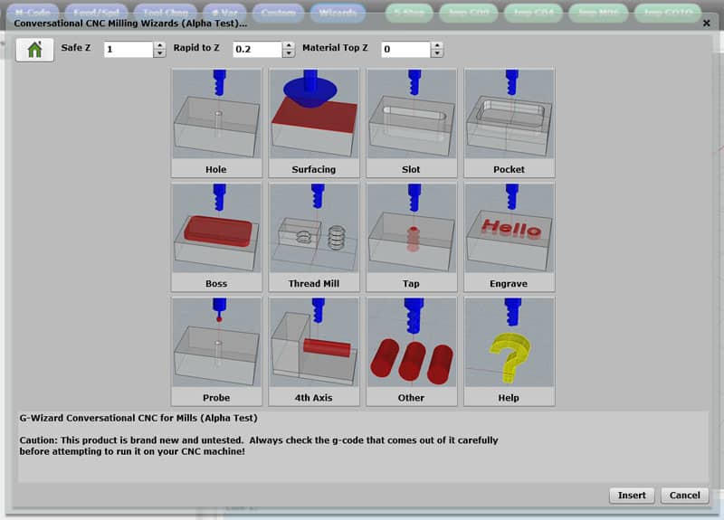

23. Conversational Wizards
Oh boy, you gotta take a look at these. They are like little baby CAM programs that do special things-drill a bolt circle, surface the top of the workpiece, make a rectangular pocket, and so on. Just press the Wizards button on the tool bar and dig in.
Conversational Wizards...
Originally we were going to charge extra for these little goodies, but they were so handy, we just couldn't do that to you.

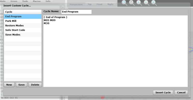

24. Custom Code Snippets
Every good g-code macro programmer has at least a few little snippets of code they use over and over again. GW Editor has a library facility for those snippets so you can keep them handy for use at a moment's notice. Just press the "Custom" button and here's what you'll see:
Custom Code Snippets...
Now you've got your own private little code locker. We've stocked it with a few snippets to get you going. Feel free to change or delete them to suit your needs.
