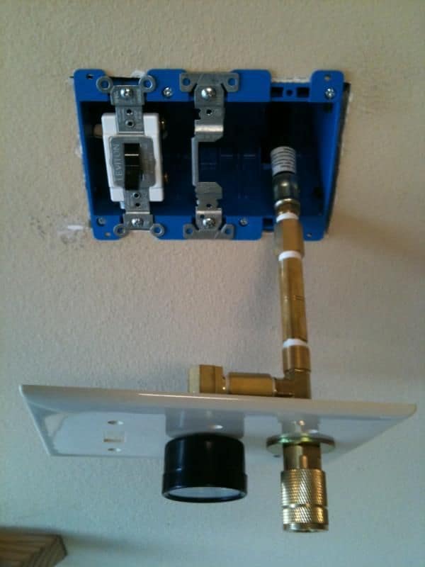

While we're on the subject of lighting, let's talk electrical and air. We want electrical sockets in both 110 and 220 (or whatever your country prefers) plus compressed air outlets everywhere. Here's what a typical air outlet ganged with a light switch might look like:
Air outlet integrated into the wall...

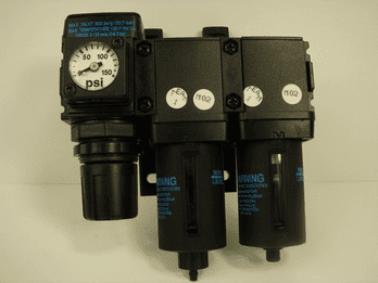

Of course nothing but the finest air will do in a shop like this, so we'll spec a rotary screw compressor with huge capacity located somewhere outside the workshop so we can't hear it at all. In fact, we'll probably put sound absorbing panels on the walls just to soak up any extraneous noise. Our screw compressor will use a refrigerated after cooler to ensure the air is bone dry, and we'll likely place automatic oilers at stations likely to be used with pneumatic tools. A unit like this one from my own shop incorporates regulator, oiler, and dryer in one piece for each outlet:
