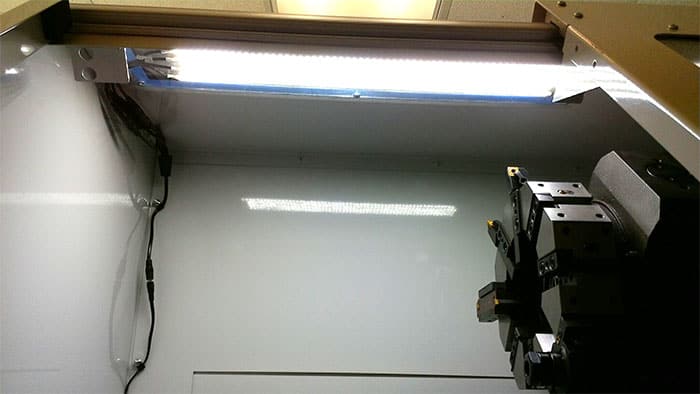

I got tired of it being so dark in the enclosure of my Tormach CNC Lathe, so got talking about lighting with my friend John Bower, who is the local Tormach dealer in Northern California. His store is called Santa Cruz Electronics, and he has all sorts of nifty electronic stuff on hand for projects liked this. Before I knew it, John had whipped up a neat and inexpensive LED lighting solution to go inside the lathe enclosure. It works great. Here’ s few photos that show what he did:

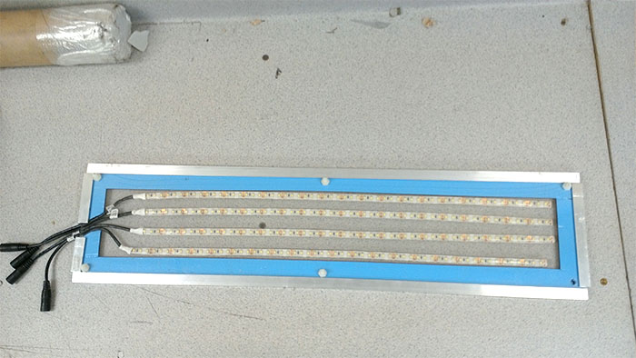

Take 4 LED strips, sandwich them in acrylic with a foam tape barrier, some aluminum channel, and silicone cement to seal it up against coolant…
Bolt to top of enclosure, up out of the way. Wiring for the LEDs is low voltage, so even if there is a link we won’t have line voltage running around inside the enclosure…

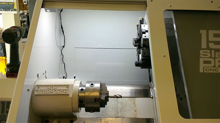

Now we have a nice well-lit lathe: thanks John!
BTW, if you’re wondering why there is an endmill chucked up in the lathe, I was boring another toolholder to take an ER collet chuck. Only had 1 on the turret and needed a 2nd for a project I’m doing. One will hold a twist drill and the other a tap. Boring them this way ensures they’re accurately aligned on the spindle axis. It’d be even better to ream the hole, but I didn’t want to spend the money for a 3/4″ reamer and this will be good enough for my purposes.

I really like the idea of sandwiching the led strips in clear plastic. I’ve avoided using the LED light strips due to them being so exposed and only mounted with a thin layer of double sided tape.
Mike, we played with the idea of just using the double sided tape and decided it was too cheezy. That’s what led to this method. FWIW, the tape doesn’t stick very well to the enclosure paint either. Having the lights come down into the whirling dervish of a lathe chuck seemed like a bad idea for some reason, LOL.
I’m really happy with this improved approach John cooked up.

To bore your tool holders, and control size better than what might happen with a 3/4″ end mill, just chuck a boring head into the chuck and then you can adjust the size a little bit at a time to get right on size.
I did this back in the early 90’s on a Hardinge Conquest 42 to build a bunch of 5C collet holders using the turret tool holders. Once the Hardinge rep saw them, they decided to build and sell them direct.
A boring head would work too, though more trouble than a reamer. As I said, the end mill has worked out fine for my application.
