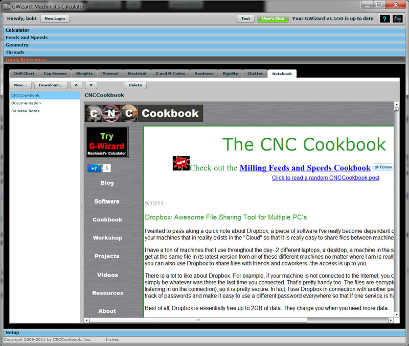

The Notebook appears on an additional tab on the QuickRef section of GWC:
The Notebook appears as the last tab under Quick References...
Every Notebook starts out with 3 default sections:
- CNCCookbook: That's our homepage so you can check on whether there are any new articles posted.
- Documentation: So you can view the doc pages for GWC.
- Release Notes: So you can view the latest release notes for GWC.

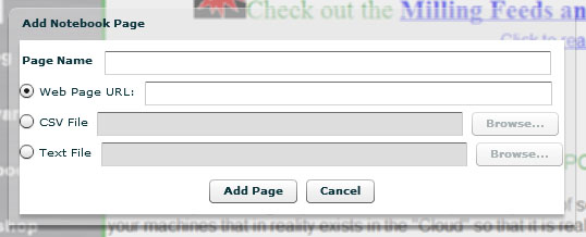

To navigate, just click on the Notebook page on the left and the pane on the right refreshes with the information for that page. Each of these default sections is a web page, but not every Notebook page needs to be a web page. Here is the "New..." popup, which shows what page types are available:
Adding a new Notebook page...
To add a new page, you specify the Page Name, choose a type, and then provide the URL or File for the page. As you can see, there are currently three page types available:
- Web Pages
- CSV Files: Spreadsheets, basically, but each file should have only one table to it, not many.
- Text Files: Text files with no formatting such as you load in the Windows Notepad.

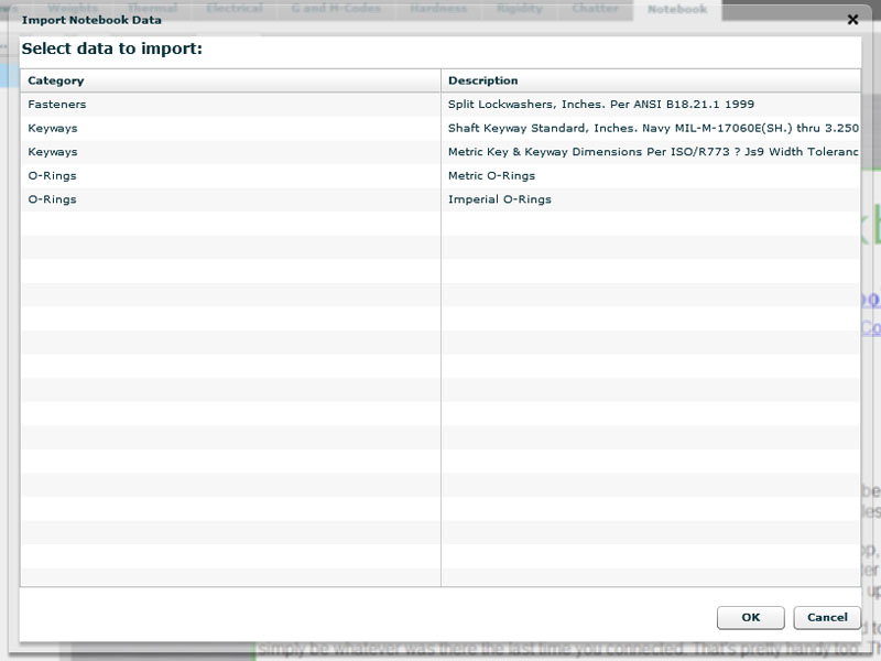

You also have the ability to download crowdsourced Notebook pages from CNCCookbook. If you click the "Download..." button you'll see a list like this:
Downloading a Notebook Page...
So far, we have 5 pages available for download. Each page has a category and a description. If you click the page, it will be downloaded to your local machine so you can access the information even when an Internet connection is not available.
