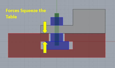

Over torquing your T-Slot hardware can lead to this, but the most common way it happens is when the slot is being jacked instead of clamped.
With a proper arrangement, the table is squeezed between whatever you're holding down and the T-Nut underneath:
Proper use of the T-Slot squeezes it...
Proper use of the T-Slot squeezes it, and it is quite strong in that configuration.

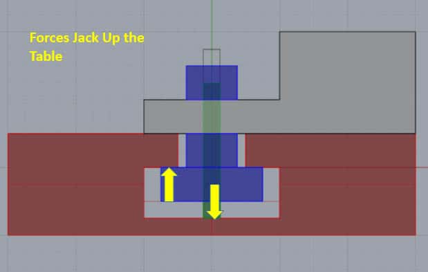

But, if the stud extends out the bottom of the T-Nut, the forces are unbalanced and pretty soon all the force goes to jacking the T-Nut up:
If the stud goes out the bottom of the T-Nut and contacts the table, the forces change...
If the stud goes out the bottom of the T-Nut and contacts the table, the forces change, and now the slot is being jacked up. The cast iron can take a LOT less force in that direction.
A good way to prevent it is to deform the last thread on the bottom of the T-Nut so you can't screw the stud lower.
