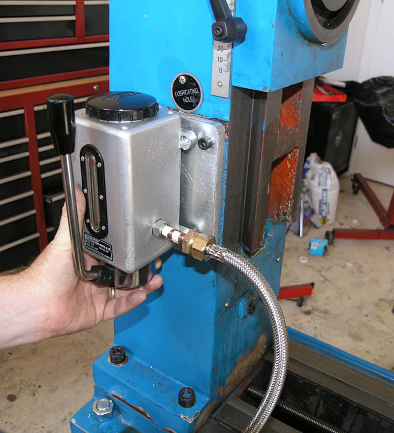

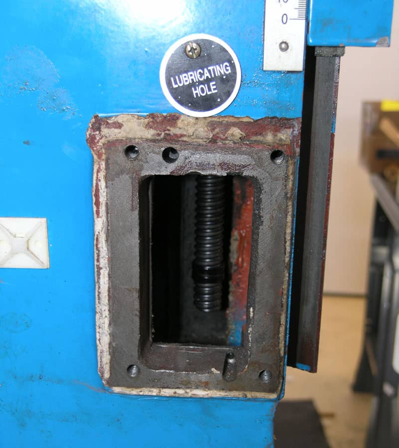

Recently, I needed to make a cover plate for my IH mill to mount an oil pump and generally make it look nicer. To do that, I needed to put 4 holes in an aluminum plate that would line up properly with the holes in the column casting:
Blue metal device with black rubber seal, silver ring, and white label reading 'LUBRICATING HOLE'.
How to locate those 4 holes on my aluminum plate?
I could fuss around with calipers trying to get the hole locations right, but what a pain. Transfer screws make it easy. So let's make a transfer screw set of M8 transfer screws for this job!

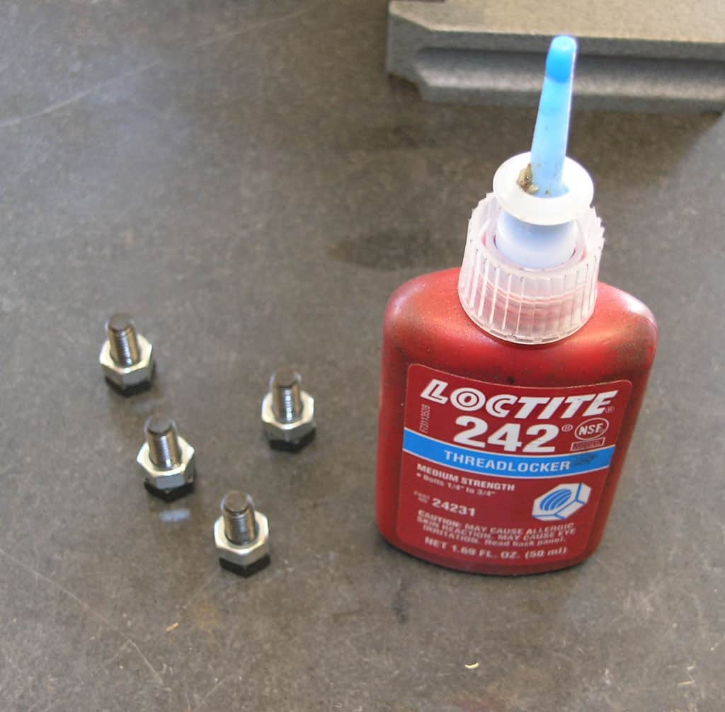

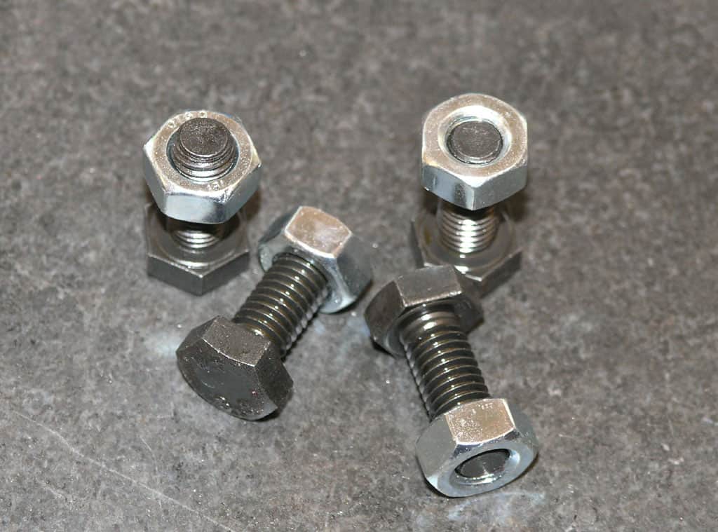

Start with 4 M8 bolts and nuts....
Bottle of Loctite 242 Threadlocker glue surrounded by six bolts on a gray surface.
I Loctite the nuts in place so they won't come loose...

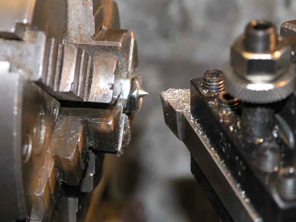

Metal lathe in machine shop or manufacturing setting.
Set your lathe compound over for cutting a 60 degree angle. Feed each pass with the compound, and set the depth of cut with the other dial. As you get close, ease of the depth of cut!

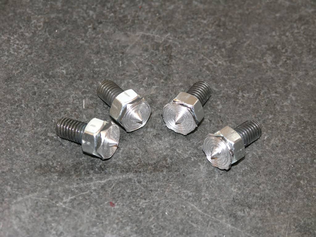

Metal cutting tool with pointed tip and metal shavings nearby.
Here's one finished!
Silver bolts in diamond pattern on gray surface.
Pretty soon you have a set...

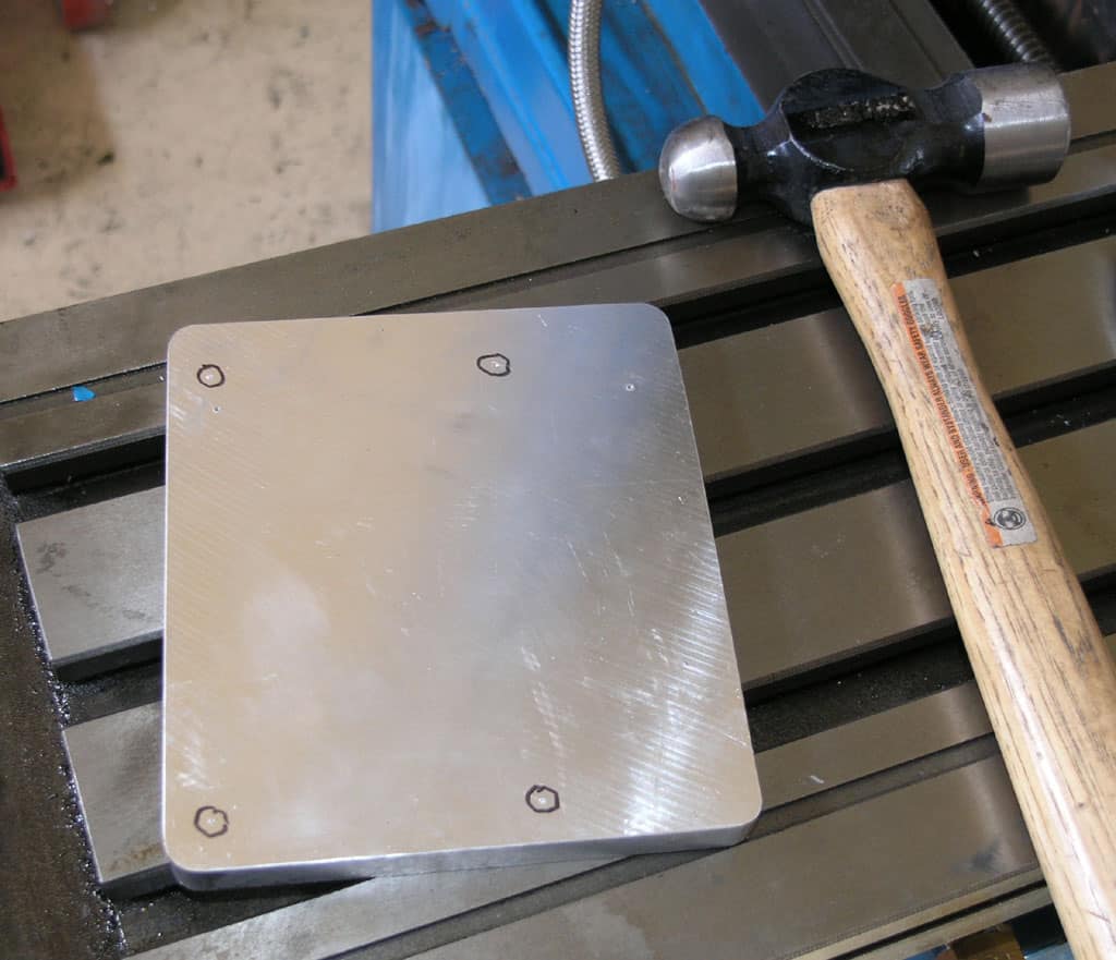

How to Transfer Screw Holes
Here's how to use the Transfer Punches to transfer screw holes:
Metal sheet on workbench with hammer handle, aluminum or stainless steel with circular indents.

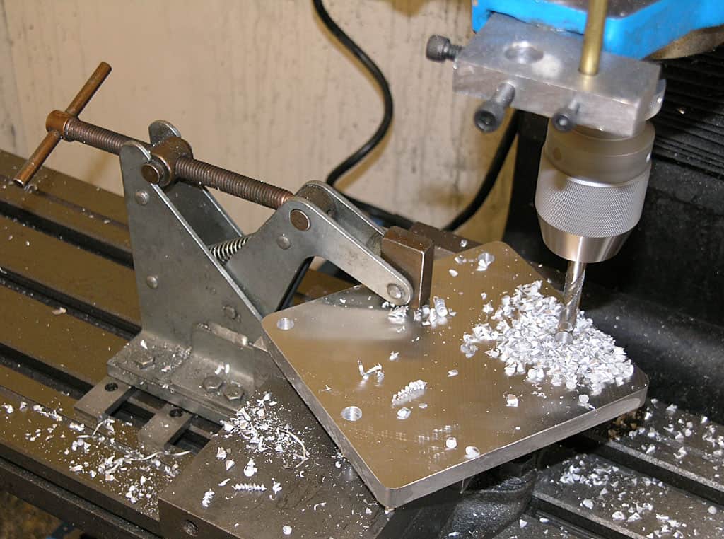

Put them in the 4 holes, hold the plate up, give it a tap, and you've located where to drill...
Metalworking vise attached to a workshop worktable with adjustable jaws and secure fasteners.
Like my funky Kant-Twist table clamp? Handy as heck. In this case, I avoided dragging out the big vise by clamping atop my little one...
Blue metal panel with aluminum plate and black dial.

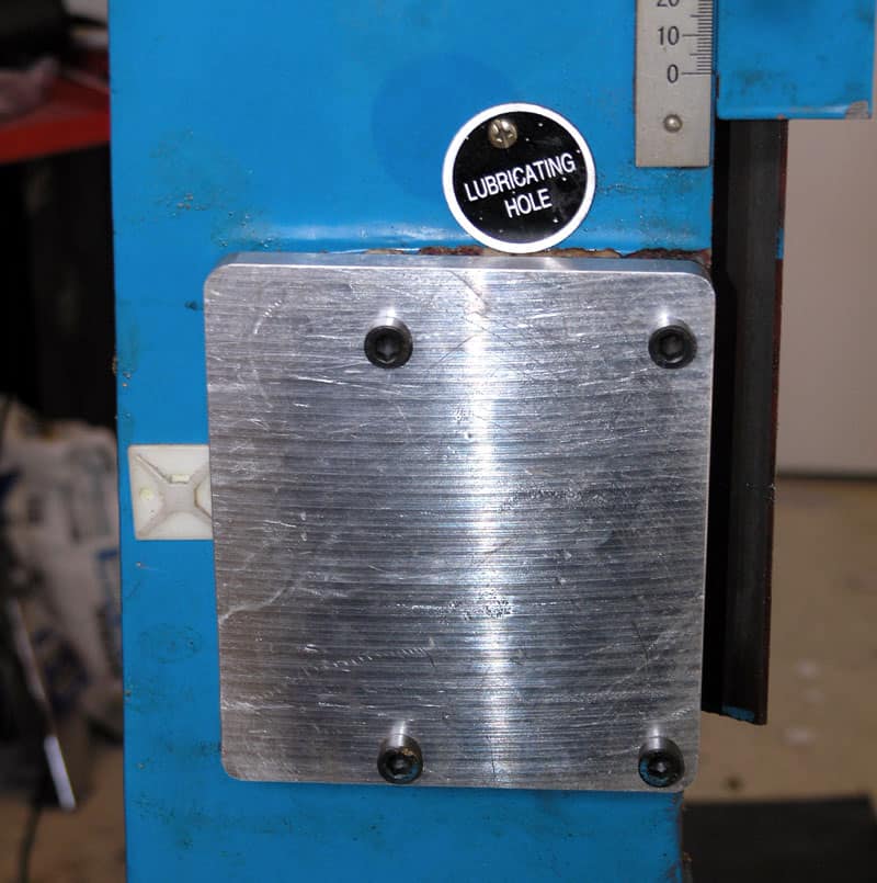

It's just that easy and just that fast...
Hand-operated drill press spindle lubrication system with oil delivery to drill bits and cutting tools.
Still need to countersink the mounting bolts and make a set of holes for the pump!
