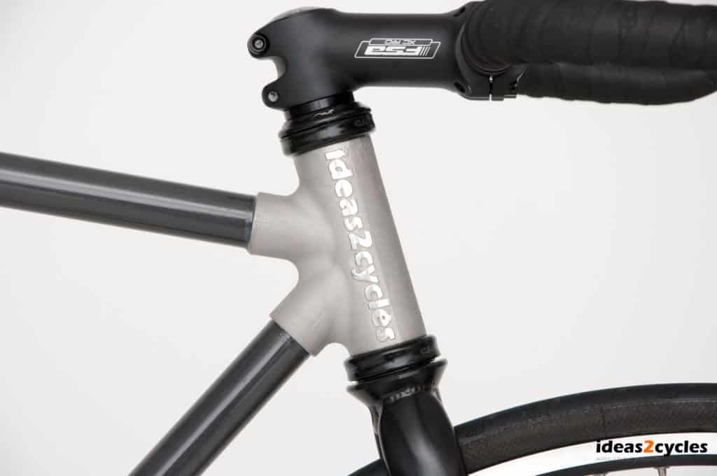

Carbon Fiber Bicycle Frame
Cast magnesium connector for carbon fiber tube frame on a bike…

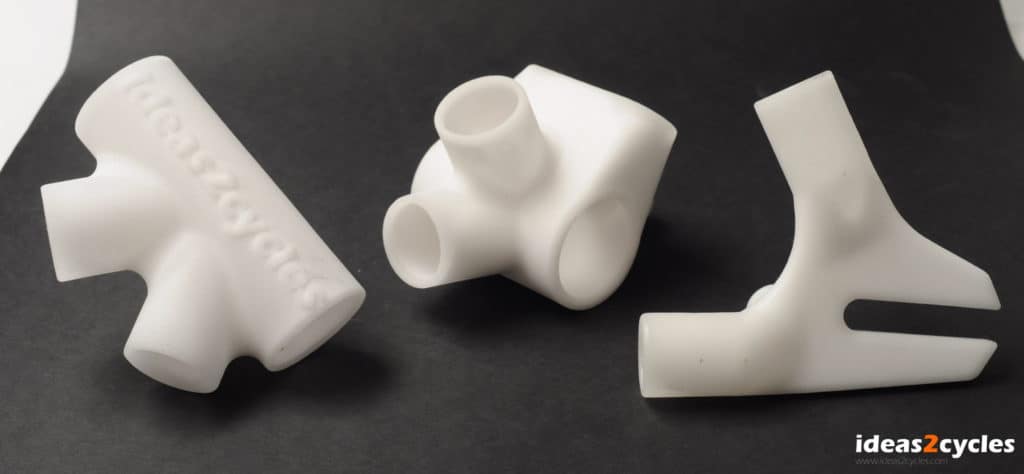

Imagine a super light bicycle frame consisting of carbon fiber tubes joined by connectors made of cast magnesium. Magnesium is extremely light–34% lighter than aluminum by volume and 50% lighter than titanium. It’s been used for such weight critical applications as Porsche engine blocks. It’s pretty exotic stuff and as most people know it can catch fire and burn with a vengeance. Casting it is no easy matter, but I love the video of Ideas2Cycles work to create the cast magnesium connectors for their special bike:
Here are the 3D Printed models used for the casting:
3D Printed Models for casting…
The video is filled with interesting information on how to create high quality castings for a project like this. For example, they used an inert gas (probably Argon) to cover the magnesium and keep it from igniting.

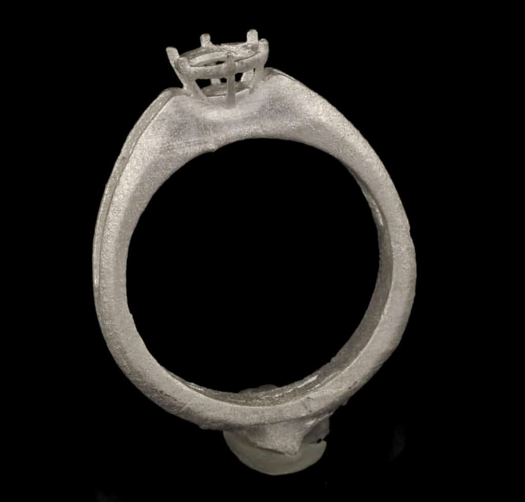

Castings can be a little rough sometimes, often due to the texture of the mold material. But for some applications such as jewelry, you want the best finish possible right out of the mold. One of the challenges for that is going to be creating a very clean 3D model to start from. Using a higher resolution printer such as the Form 1 3D Printer is a great start.

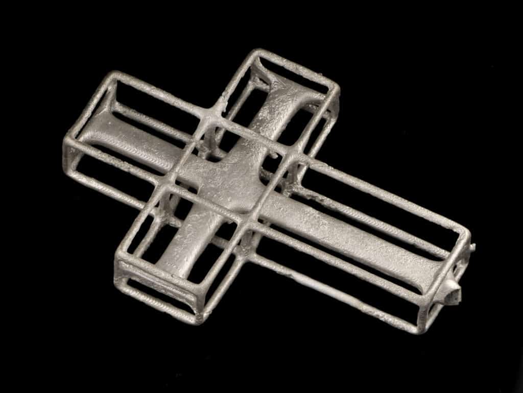

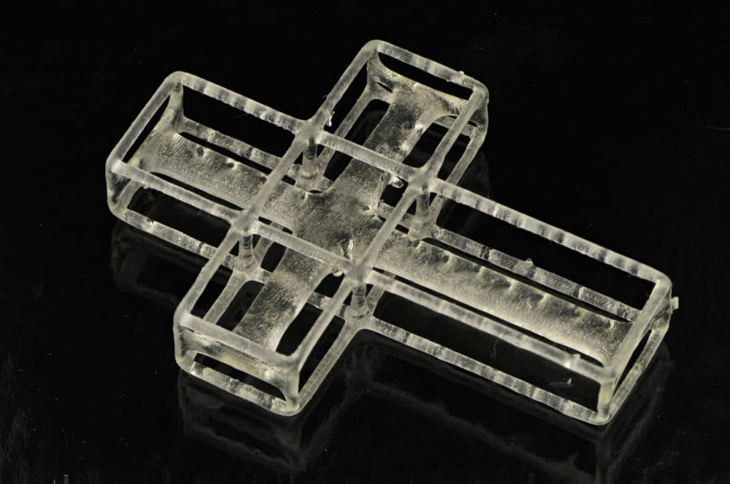

Check these photos from the Form 1 user forum that show some of the results that are possible for jewelry makers:
Clear Resin model of a suspended cross…
The cross, now casted…
A ring…

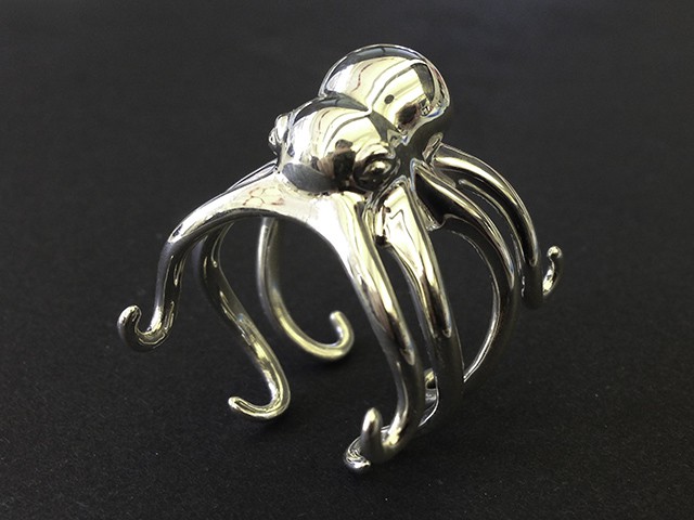

I’m a scuba diver and love all sea critters, large and small. How about an octopus ring like this one:
Octopus ring by Museum of Small Things…
Not only that, but you can list your designs on Shapeways for resale. With a little help from a service like this, you can design items at home, print the prototypes on your 3D printer to get a real feel for how the 3D object will turn out, and then have them printed in metal at a reasonable cost.
