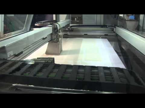

Sand such as is used for casting is a good medium for 3D printing. The green sand already used for casting is a combination of ingredients that help it to hold the shape of the pattern placed in the sand. The pattern is a reproduction of the part to be cast so that the sand forms a negative image of it.
In 3D printing the mold is built up layer by layer in typical 3D printing style. Binder chemicals are used to lock down the sand in the proper shape. Casting hollow parts requires cores, which can also be 3D printed at the same time. Best of all, the sand without the binding chemicals supports all these parts as they’re being made, not unlike the laser sintering process. The molds and cores come out of the sand just as they’ll be used at the foundry.
Here’s a video of the whole process using an ExOne machine to make a bunch of molds in sand:
You’ll note the work area for the 3D printer is quite large–like a gantry router. This allows either creation of large molds or packing a bunch of smaller work together. Filling the entire work volume of the machine requires up to a 24 hour 3D printing job.
