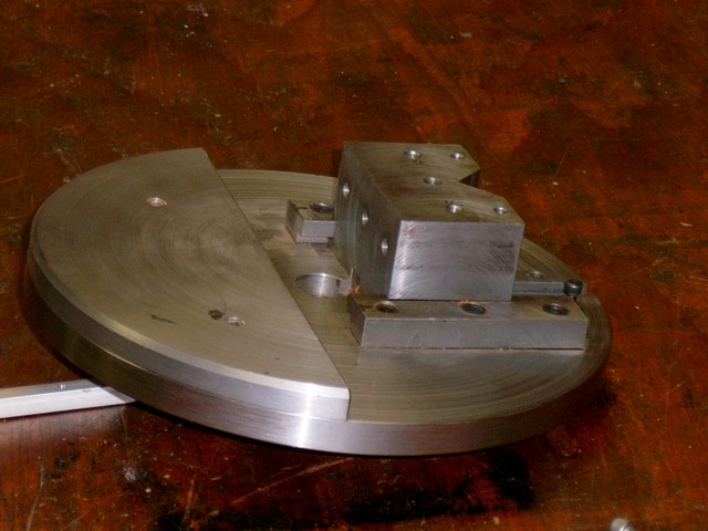

Sliding Block Faceplate
Thanks to Oldmechthings, I became aware of this unique fixture. It'd be handy if you had to do very many eccentrics: a sliding block faceplate:
This faceplate has an ajdustable off-center slide that also serves as a clamp. Sweet!
Here is another version of the sliding block face plate:
And another built from a book by Marlyn Hadley called MODEL MACHINES Replicas Steam Models:
I keep thinking there is a way to design one of these with a precision screw to allow precise calibration of the eccentric offset.
The English have a thing they call a Keats Angle plate that can be attached to an existing faceplate to create a similar fixture:
I like the idea of a set of "ways" that move the slide in a precise way better. Put a screw on that bad boy and dial in whatever you'd like very easily!
