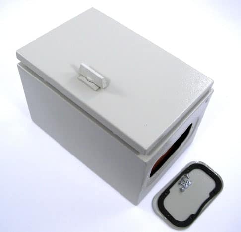

I'm concerned about chips or coolant getting into the VFD's cooling slots, so I'm doing quite a bit of agonizing over just where to mount it. Most people mount their VFD's up high on the mill head, but this seems exposed to an errant chip. Another possibility is to mount mine on the NEMA enclosure along with the rest of the electronics. Unfortunately this would put it even closer to where chips are being slung that if I stuck it on top of the mill.
My conclusion is I will mount the VFD in a box either on the mill (most likely) or on the wall behind the mill. If I build a flood cooling enclosure for the mill, I may move the box onto the outside of the enclosure.
Based on the VFD manual, I need a box on the order of 9" wide x 13" high x 6" deep. I will likely provide a receptacle on the box for the motor, a 5-pin connector of some kind for control signals back to the CNC enclosure, and a cord with twist lock plug back to the existing receptacle I use for the mill. This box is quite a big larger than the VFD to provide room for cooling.
I wound up buying this little NEMA enclosure on eBay from seller electrical_parts for $50:
It's slightly smaller than the desired dimensions, but not by much. I need to decide whether to put a fan on the box too.

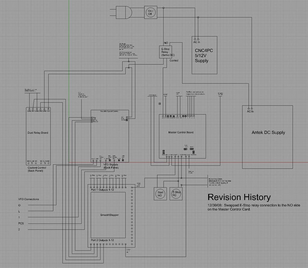

I'm running a Hitachi L200-015NFU VFD. It's good for up to 2 HP motors, and cost about $200. Rumor has it my CNC4PC motor control board will put out a little voltage even when Mach3 hasn't commanded it to run, but that the VFD has a programmable parameter to deal with that. The answer is to select the active portion of the analog input voltage range. Set parameter A013 to say 1volt (this is set in a percentage) and set parameter AO15 to 0Hz (this should set the frequency to 0 Hz when the cnc4pc is outputting any voltage less that 1 vdc (the AO13 value), and turn off the motor. I'll need to remember to do that when I set up the VFD!
This particular VFD delivers full torque over a 1:10 speed range, so for example with a 1700 rpm motor I can still get full torque at 170 rpm. The output frequency range is 0.5 to 400 Hz, so in theory, I could run my motor quite a bit faster than its rated speed. The problem in doing that for any time is the motor's bearings are probably not rated for it. The accuracy is 0.1% of the maximum frequency.
The input signal is a 0-10 VDC signal, a forward run/stop signal, and a reverse run/stop signal. This is very compatible with my CNC4PC motor control board which will output all 3.
Some configuration notes:
1. Make sure the TM/PRG dip switch is set to TM to accept control from the input terminals.
2. The motor wiring should be AWG12.
Control Wiring:
0-10 VDC output from CNC4PC: Terminal "O"
Ground for 0-10 VDC from CNC4PC: Terminal "L"
CCW1/NO from CNC4PC: Terminal "1"
VCC from CNC4PC: Terminal "PCS"
CCW2/NO from CNC4PC: Terminal "2"
Since the connections to run foward (Terminal "1") and backward (Terminal "2") are NO, and the relay has to close to trigger the spindle, we can assume that E-stop cutting the power to the motor control board will open the relay and thereby stop the spindle in the event of an E-Stop.
Here is the overall schematic for how the VFD is controlled by the system:
Preliminary, and for informational use only. Do not use as a plan for your CNC machine!
I'll be using 22 AWG shielded 6 conductor cable to route the VFD control signals back to the VFD NEMA enclosure.
