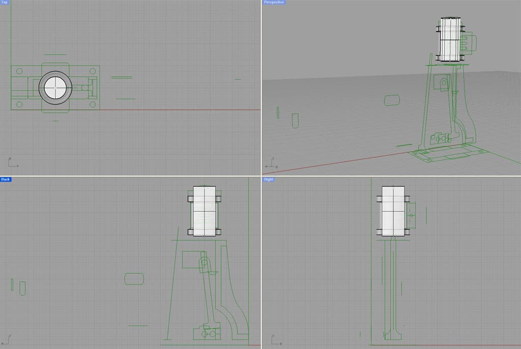

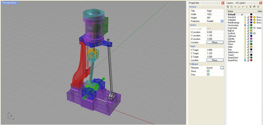

3D modeling software interface with complex mechanical device and color-coded components.
First thing to note is I have placed each part on its own layer. See the menu on the far right for layers? This lets me set each color independently and turn the layers on and off independently, making it easier to work on the parts individually.

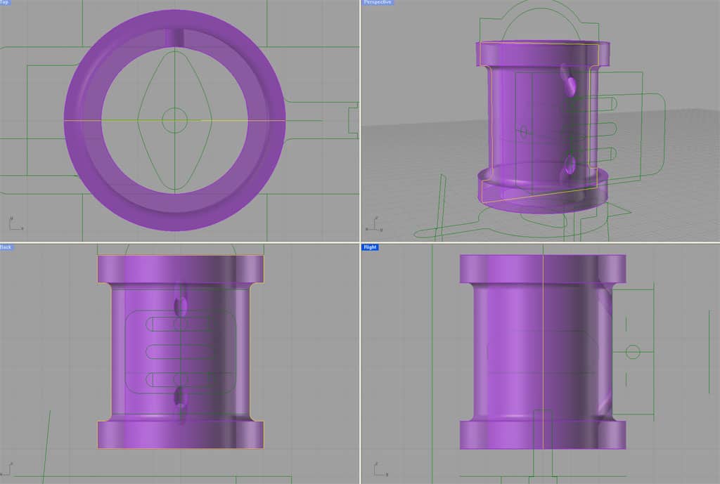

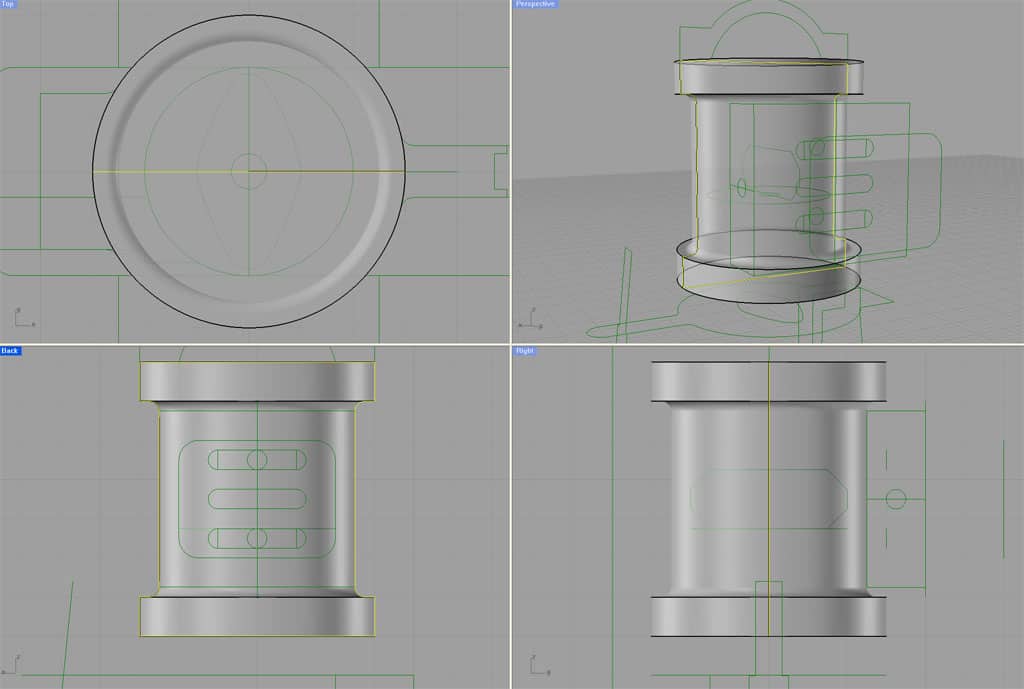

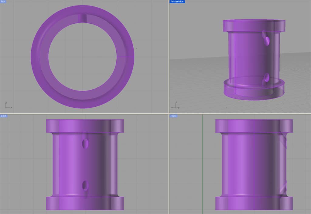

Cylindrical object with rounded edges and smooth surface, shown from top, side, front, and back views in 3D rendering.

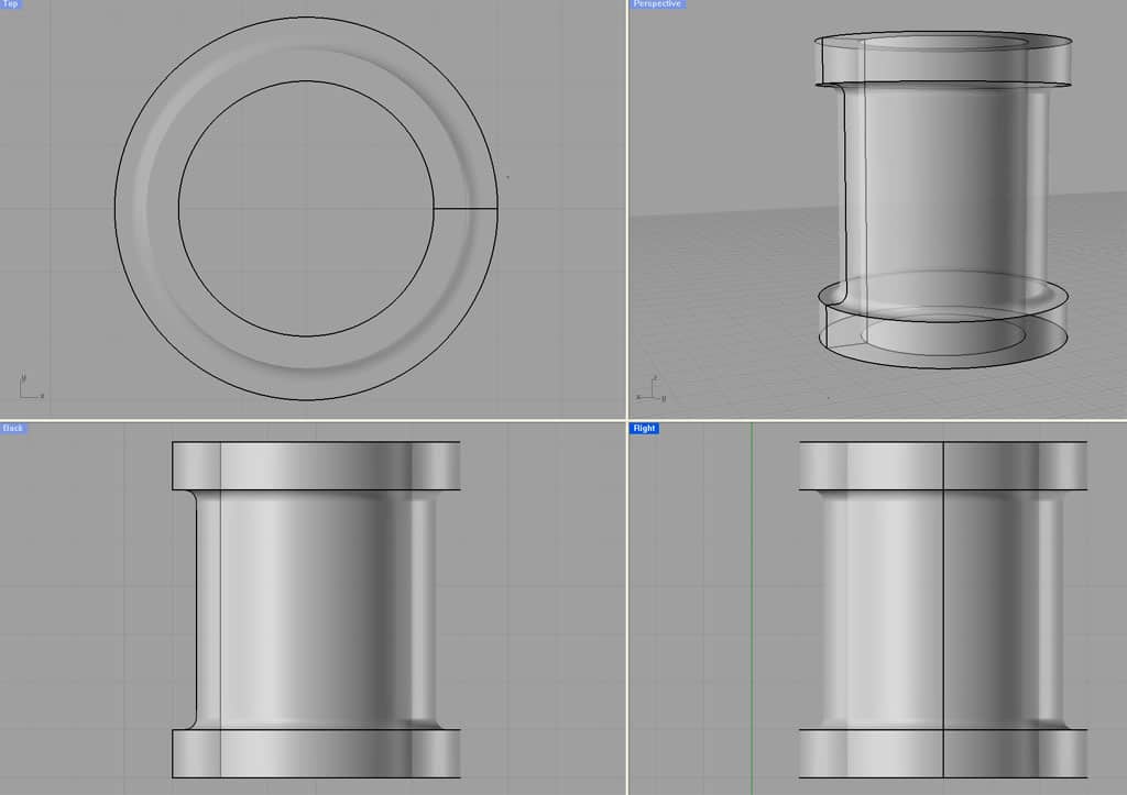

Here I have turned off every layer but the cylinder so I can see and manipulate it easily without clutter or damaging the other parts. You can see the steeply angled steam ports that I wnat to get rid of for a better idea.

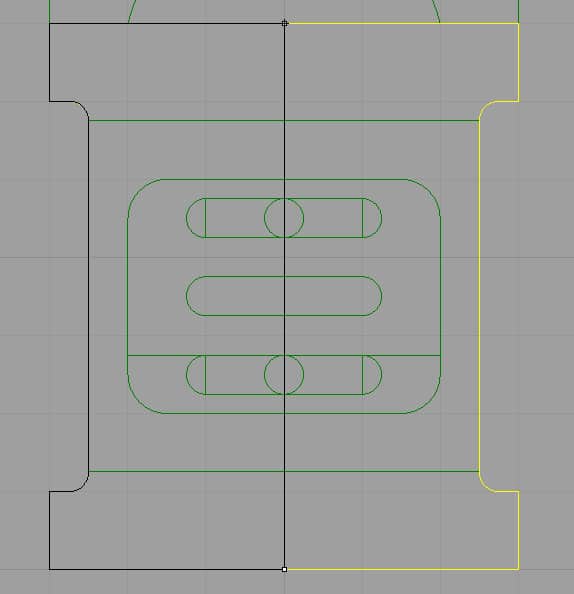

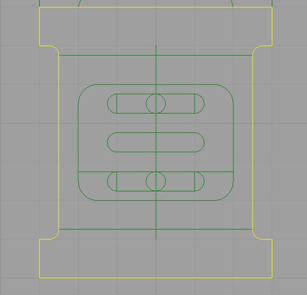

In order to "fill" the old steam port holes, I'm just going to remake the cylinder. Here is the original 2D profile I used to make the cylinder. You can also see some lines associated with the steam box.
Technical drawing of a CAD design on a gray background with green lines and rounded rectangles.
I use a command called "Revolve" to spin that profile to create a cylinder. It just spins 1/2 through 360 degrees. That half is lit up in yellow and the spin axis is shown as the black line with two endpoints at top and bottom.

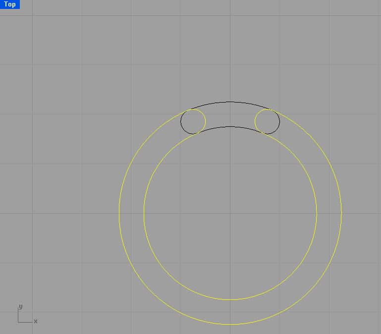

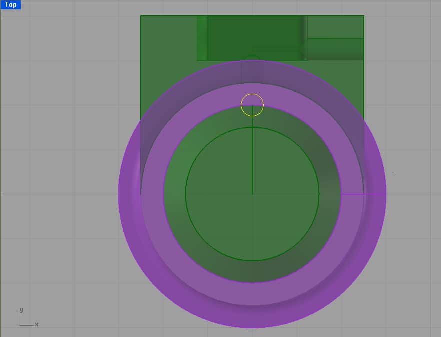

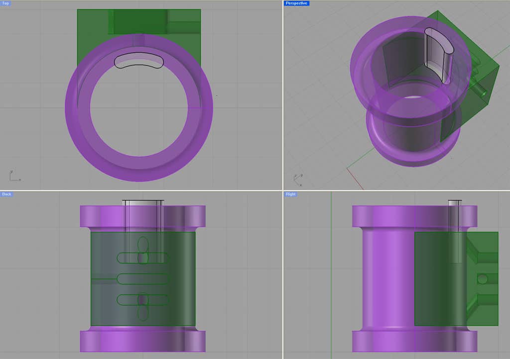

We're now ready to cut our new steam passages. The original suggestion was just to plunge an endmill to create a groove in the location shown. That would work fine, but I have the ability with CNC to do something fancier.
A CAD model of a circular object with concentric circles and purple outer ring.

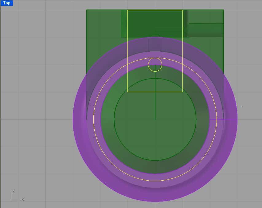

What if I take that 1/8" endmill and sweep it along the circular path shown within the confines of the rectangle that was created from the steam chest ports?
Technical illustration of machinery parts with yellow lines and gray grid.

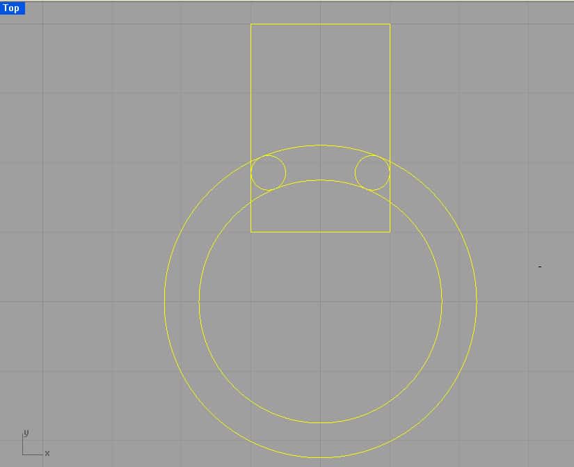

Here are all the construction lines. Note that Rhino made it easy for me to select the box and the two big circles and it figured out how to exactly postiion the small circles for me.
Technical illustration of two concentric circles connected by an arc.

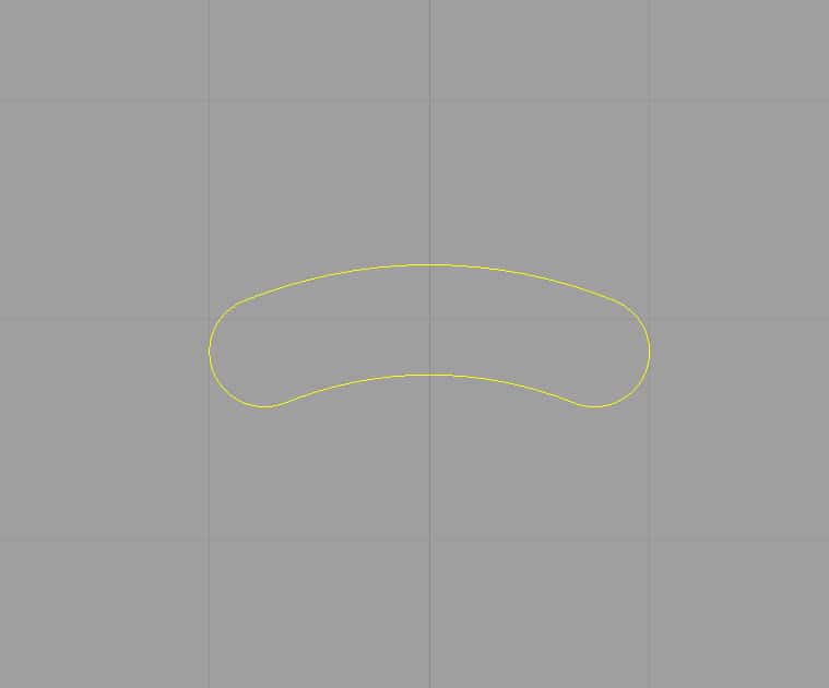

I mark and subtract the lines I don't need....
Yellow oval shape with curved top and flat bottom.
And here is the path the 1/8" end mill would take...

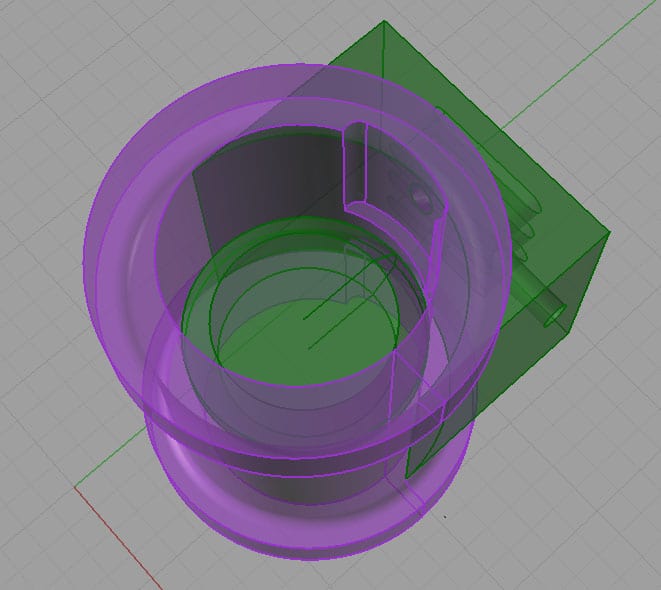

Now I extrude that shape up...
A 3D CAD model of a complex mechanical component with intricate design and multiple parts, featuring purple and green colors indicating different materials.
I copy another one down and properly aligned with the lower steam port on the double-acting cylinder.
CAD rendering of a 3D object with a circular base and cylindrical center.

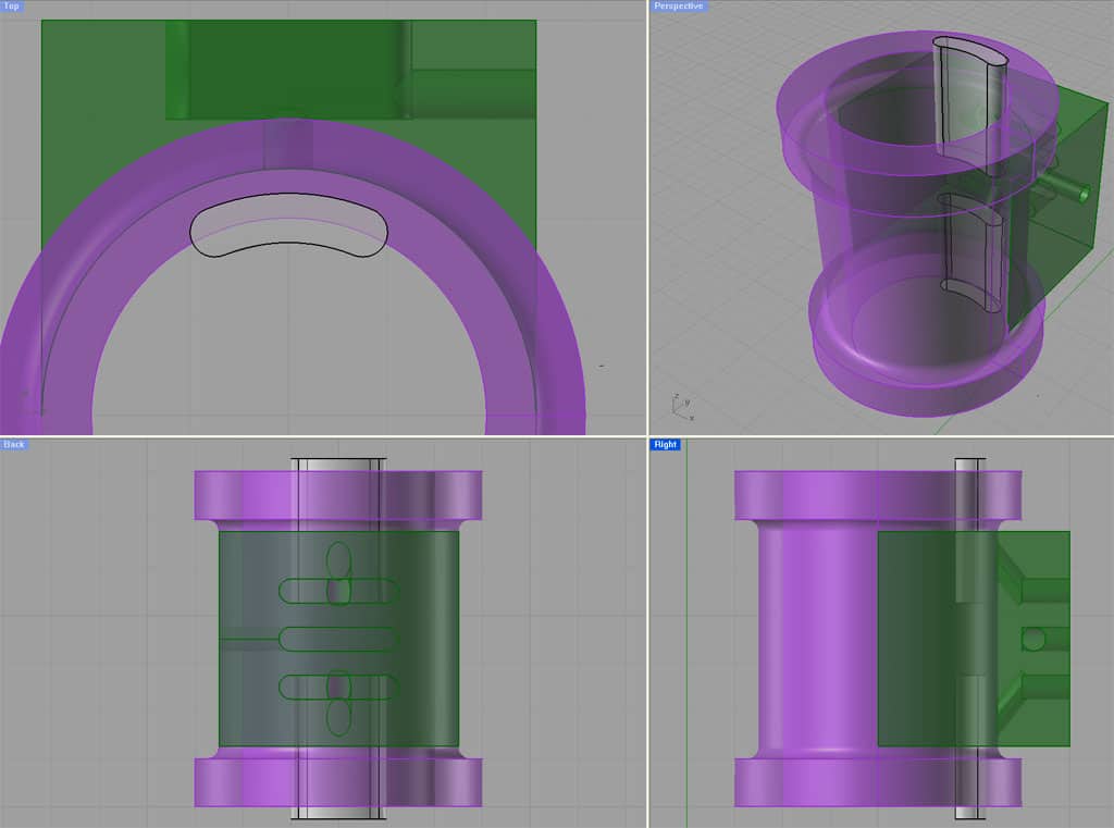

I do a Boolean Difference and voila! Now I have a Hot Rod Port job on my cylinder. Lots more surface area to flow steam than I had before. And the setup will be way easier than the angle hole drilling. I still need to open up the side where the steam chest goes, but I won't bother showing all that here. You get the idea!
