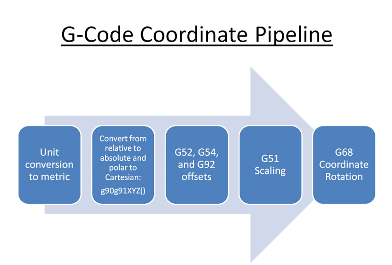

The first stop on the 5-Step G-code Coordinate Pipeline is Unit Conversion, and this chapter is all about delving into that subject.
G-Code Coordinate Pipeline process infographic.
5-Step G-code Coordinate Pipeline...
The coordinate pipeline shows how coordinates go from the numbers in the G-code program through various transformations to arrive at the numbers the machine actually uses.

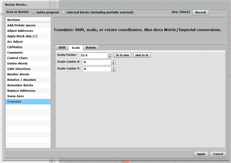

There's a better way though. G-Wizard Editor (our nc viewer software) has a unit conversion facility and will automate just about everything for you. If you think about it, unit conversion is largely a matter of scaling the coordinates. GW Editor has a "Translate" revision that can do offsets, scaling, and rotation. Select it via the Tools Revise menu. When it comes up, pick the "Scale" tab:
Gray computer program screenshot with various tabs and title bar.
Select Tools Revision, the Translate revision, and then the Scale tab...
There are two buttons, "in to mm" and "mm to in" that plug in the correct scaling factor. Pick the one you want, press "Apply", and GWE will do the rest. After it has finished, make sure there is a G20 or G21 G-code (whichever is appropriate) at the top of the program so everyone (and every controller) knows what units are expected.

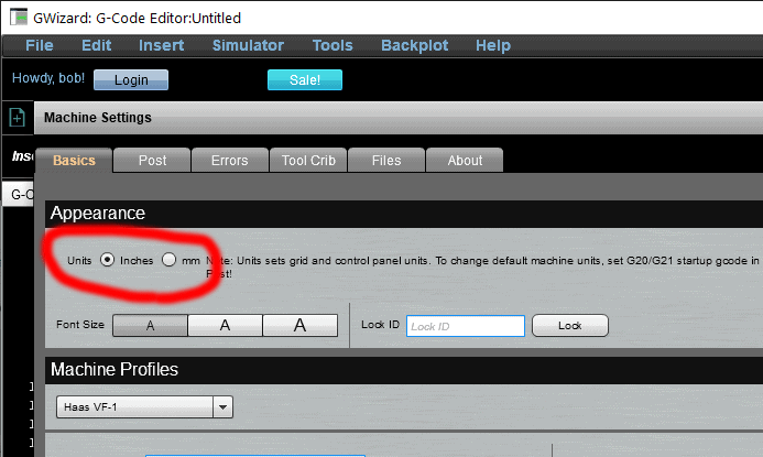

1. Set them on the the first tab of the Setup screen:
GWizard G-Code Editor interface with inch unit selection.
This sets up what kind of units will be used by the User Interface of the program. So, for example, the background measurement grid in the backplot area will either be ruled in inches or millimeters. Note that when I say the UI, you have to carefully distinguish whether a prompt is asking you to input a coordinate that is going into the G-code program or not. If it is, there will be no unit conversion done on that coordinate-it's treated just as a number and directly used with the program without regard to units.

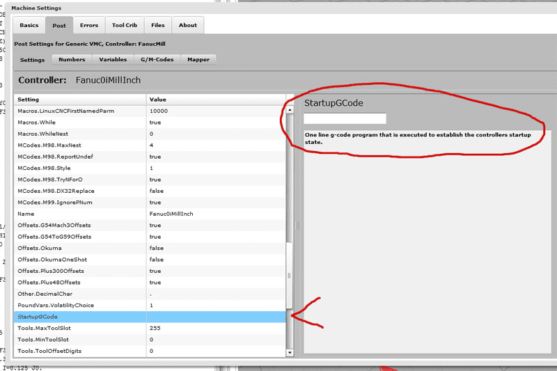

2. Set the units via G20/G21. This tells GWE what the G-code program's units are, as we have been discussing, and changes how the backplot is scaled versus the background grid. By default, GWE will start in G20 Imperial mode, but you have the ability to override that too. GWE has the ability to execute one line of G-code silently before it starts simulating your G-code. You set it up as a post variable:
Computer software settings page with customization options.
Just plug a G21 in there and GWE will assume part programs are Metric, unless it finds a G20 in the program itself. Some of the canned posts we have available are pre-configured to metric in this way, but it's easy to convert a post by adding a G21 if we don't already have a metric version of your post available.

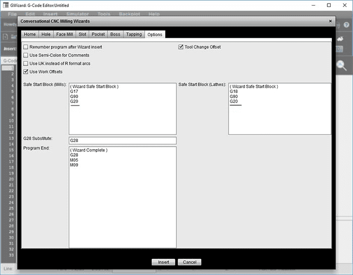

3. Set up your Safe Start Code to include either G20 or G21 whenever you use a Conversational CNC Wizard. Just click the "Setup" tab choice on the Wizard Popup and edit the Safe Start Code for lathe or mill:
Machining software interface with settings and options.

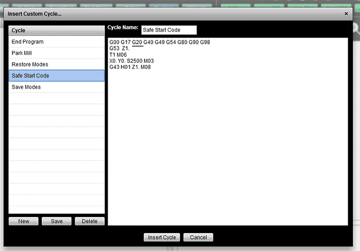

4. You may also want to edit the Safe Start Code for the Custom snippets button on the Tool Bar:
Machining program custom cycles options list screenshot.
