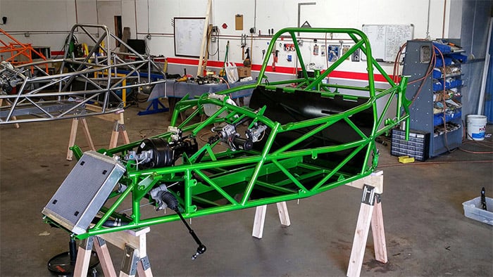

Suppose you had to build a bunch of space frame tube chassis like this one:
GoblinFrame
Making a bunch of space frames means notching a lot of tubes…
Making all those space frames means notching a lot of tubing.  Sounds like a little CNC-style automation is in order.  That resulted in this CNC-driven plasma cutter tube notcher that I came across over on Reddit:

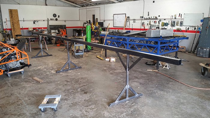

Start by welding up a simple frame.  The plasma torch will ride along that rail…
