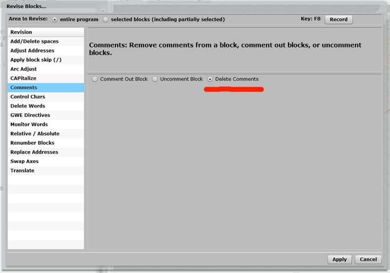

Comments are for people, so unless there are messages in there and programmed stops that the operator needs to see, comments are easy to give up. Unfortunately, there typically won’t be a huge savings because there aren’t that many comments especially in CAM generated code, but every little bit helps.
To eliminate them, use Tools | Revisions | Comments | Delete Comments:
HomeSwitchRearPanelEngrave: 21670 bytes (Only saved 223 bytes, about 1%)

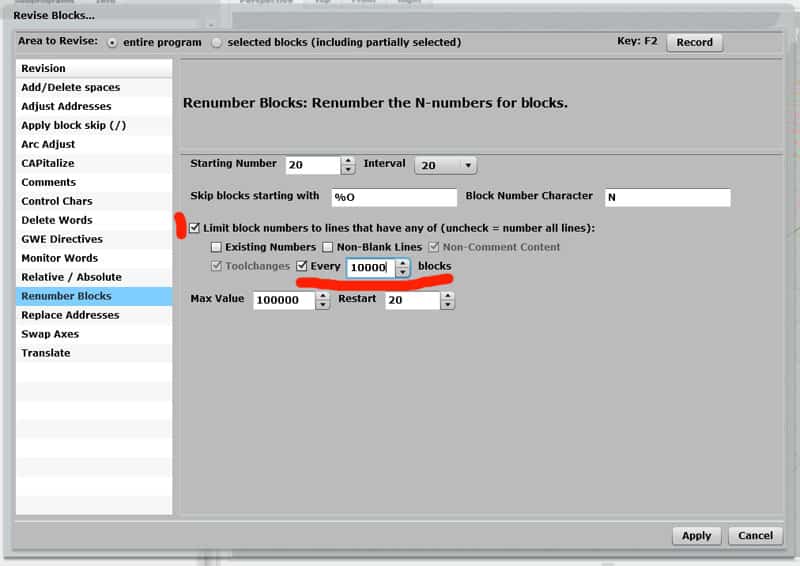

Step 2: Get Rid of Block “N” Numbers
In most programs, every single line has a block number, so this yields better results than deleting comments. To accomplish the task, we used GWE’s Renumber Revision and told it to only number every 10000 blocks:
Just tell it to “Limit block numbers to lines that have any of”, then uncheck all the boxes except “Every … blocks” and stick a big number in there. GWE will delete block numbers except for every 10,000th block. If you find the block numbers helpful, perhaps you can get by numbering every 5th or 10th line as a compromise.
HomeSwitchRearPanelEngrave: 17212 bytes (Saved 4458 bytes, about 21%). That’s a quite a bit more cnc memory savings.

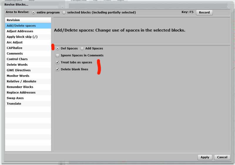

Step 3: Get Rid of White Space
If you’re following along with your own copy of GW Editor, you’ll notice that while the block numbers and comments were deleted, blank lines where not. It turns out gcode doesn’t care much about spaces either (at least most dialects don’t), so we can squeeze out all the white space for more savings. We’ll use the Add/Delete Spaces Revision to perform this task:
HomeSwitchRearPanelEngrave: 15560 bytes (Saved 1652 bytes, nearly 10%). Decent cnc memory savings, but not huge.

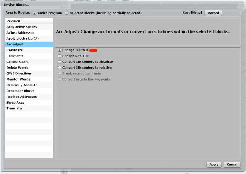

Step 4 (Optional): Convert IJK style arcs to R style
I’ve labeled this step optional because you need to be sure you can check the results. Not all IJK arcs can be translated to “R” format and GWE can’t necessarily identify all of those cases automatically. So, you want to make sure you go over the backplot carefully to make sure everything is as you expect. However, if you’re willing to go to the trouble, the savings can be significant. Here are the settings I used for the Arc Adjust Revision:
HomeSwitchRearPanelEngrave: 13204 bytes (Saved 2356 bytes, another 15%). Every little bit of cnc memory savings helps!
