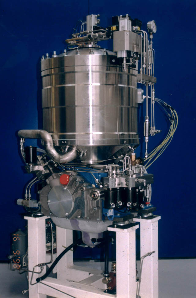

What I am curious about is what sort of Stirling engine is needed to power such a beast? It may be that the Sandia version is too exotic to fabricate and one would have to settle for a lower efficiency. I’m not too concerned about that. Even half as efficient is still just as good as solar cells (photovoltaic) and I’ll bet cheaper. Apparently they used a Scandinavian designed Stirling called a “Kockums 4-95 Stirling engine“.
Apparently it was originally created to power submarines. It looks a bit imposing for the average home shop, but recall we only need on with 1/8 the capacity, so it will be considerably smaller. Considering what this one is capable of, it seems relatively compact. The one that was finally perfected for this solar application is even smaller than the picture above, and is apparently about the size of a 55-gallon oil drum. 1/8 of that is not small, but ought to be manageable for many home shop machinists.

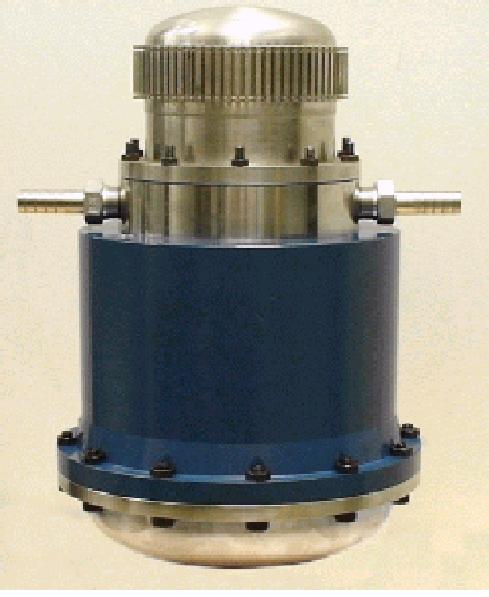

This is where I run out of steam, so to speak. I’ve no idea what’s inside all of those intricate housings, and I haven’t seen plans for any large scale Stirling’s in the Model Engineering community. The best I was able to find is the Sunpower EG-1000 1 kilowatt Stirling generator, whose design looks simple, compact, and doable. The generator is an integral linear design, which is cool. A more detailed scientific paper is also available. Here is what a 1 KW version looks like:
In practice, imagine flipping that drawing over so the focus of the parabolic reflector was the heat end. This particular unit is designed for water cooling. Just like the Sandia/Kockums unit, I would propose small (motorcycle?) radiators with a fan to cool the water on the side facing away from the solar collector. A few more factoids on the EG-1000:
  • The piston and displacer are only moving about 9mm at peak efficiency.
  • It operates using a planar spring.
  • There are no linear bearings. Rather, gas bearings support the design and require no lubrication.
  • It incorporates a linear generator based on moving permanent magnets and a specially wound coil.
I suspect it will require considerable experimentation to produce a workable Stirling for this application. It’s my understanding that they can be finicky beasts to get running and are very sensitive to friction and other factors. Were I to undertake such research, I suspect it would make sense to build the dish, measure the heat available at its focus, and then build a testing rig that delivered that heat via electric or gas fire so I could fiddle with Stirling engines in the comfort of my own shop.

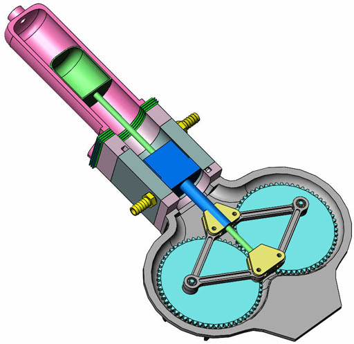

The Rhombic drive is similar in design, but converts the motion from linear to rotary:
It seems to me that a working rhombic drive design could be considerably simplified as a free-piston linear design. Free-piston Stirlings need a load that is provided by the linear alternator/generator.
