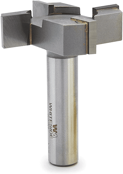

#1 Whiteside 6210
Shank: 1/4"
Diameter: 1"
Cut Depth per Pass: 1/4"
Flutes: 3
Full Width, 1/8" Deep Cut: 0.89 HP / 669 Watts
This cutter uses cemented carbide, so the inserts are not replaceable.

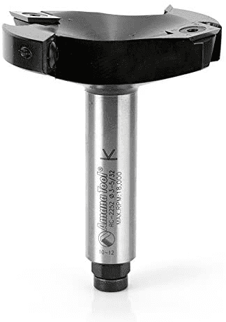

#6 Amana Tool RC-2252
Shank: 3/4"
Diameter: 3.1496"
Cut Depth per Pass: 0.4688"
Flutes: 2
Full Width Cut: 4.2 HP / 3.1 KW
This cutter uses replaceable inserts. Of the popular spoilboard cutters in this article, this one is the Beast. Use only with an industrial grade router and spindle. It's a 2+2 design, so it will produce cleaner cuts at the corner.

#8 Whiteside 6220
Shank: 1/2"
Diameter: 2"
Cut Depth per Pass: 1/2"
Flutes: 4
Full Width Cut: 5 HP / 3.3 KW
