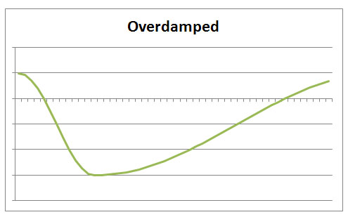

The opposite of underdamping is (pretty obviously) overdamping. It looks like this:
Overdamping has no oscillation, but damping really slows down the curve moving to commanded position too much...
The overdamped servo does not oscillate, but as we can see, too much dampening really slows down the ability of the curve to reach equilibrium and stop moving. It makes it sloppy, as though the servo is afraid and creeps up on the commanded position. Imagine your mill cutter is a racecar running through the curves that are the desired cuts on your workpiece. An overdamped servo means that the racecar is always a little slow to respond to where it should be. Take a sharp turn and the driver is too slow or timid, turns the wheel late, and the car swings a little wide. This is not very accurate, although at least it does not oscillate. Still, it is an undesirable and unacceptible condition.

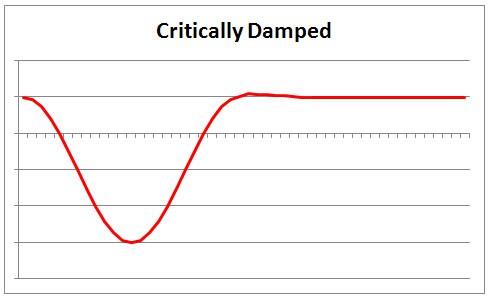

Here is the condition known as "critically damped":
Critically damped is just right!
In a critically damped system, the initial command to move creates a large error which the servo rapidly closes and then it stops moving when it gets there. Pretty simple, eh? Servo performance doesn't get any better than this.

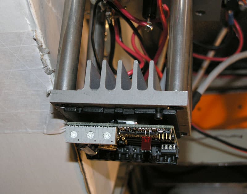

On my Geckos, I start out a tuning session with the Gain and Dampening trimpots in about the 11 o'clock position. This should be enough to allow the servos to at least remain stationary without faulting. If they fault, try a little more Gain, but it's likely you have a problem to diagnose if that doesn't fix it up pretty easily. See the troubleshooting page for help.
Now tuning is pretty easy. "Bump" the axis, or as some will say "disturb" the axis. That means to move it. It's time to move it, move it, as they said in the movie. Use a motion that has a fair amount of acceleration and speed, like a fast jog. Also try changing direction. Then stop. What happens? If nothing happens, turn up the gain a little bit and try again. You are trying to provoke oscillation. When you get some oscillation, advance the dampening slightly until the oscillation stops. Try again, first without moving the gain. If there is oscillation, turn up damping slightly. If not, turn up gain slightly. Be conservative on the dampening, because it is hard for you to detect overdamping by ear. You want just enough to eliminate oscillation, which should be readily audible.
You will go through this cycle of upping gain and then damping oscillation several times. If you stop too early, the holding torque on your machine will be "soft" and you will not have "tight" servo control. When you have ridden the gain up until you have almost no travel left on the damping pot to stop oscillation, you are done. You've gotten as much gain in as you can while keeping it damped. Hopefully it is critically damped and not overdamped. Now try disturbing the axis again, but this time use a variety of speeds and accelerations and travels to different locations on the axis. You want to make sure you haven't overlooked some little area of the performance envelope where oscillation still exists. That's why you kept a little extra dampening travel available.

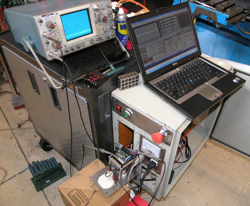

Here's how I connect my Tek 465 oscilloscope on the Gecko 320 drives:
- Connect Channel 1 to the Gecko 320 test point (the location is shown in the Gecko documentation). DC couple this input. Use the blue capacitor's ground lead to ground this probe.
- Connect Channel 2 to the direction signal. You will be measuring (or triggering) the curve whenever the axis changes direction. DC couple this input. Ground to the blue capacitor, or leave ground disconnected and the scope will use Channel 1 ground.
- Set trigger to "normal", trigger source to "channel 2", and trigger edge to "+".
- Set the scales to 2V/cm vertical and 1 millisecond/cm horizontal.
- Adjust the vertical position of the trace so it is near the bottom, rather than in the middle of the screen.
Oscilloscope is connected, but the axis isn't moving yet. I also haven't set everything up or you wouldn't see that trace without a moving axis!

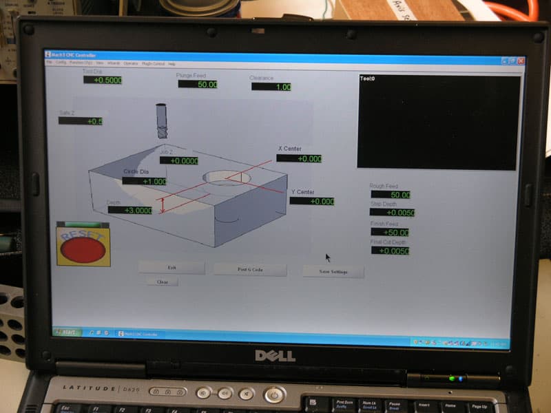

I use the circle pocket wizard's G-code for servo tuning. Set a small diameter circle and a relatively high feed rate and you'll get lots of direction reversals to use for tuning...

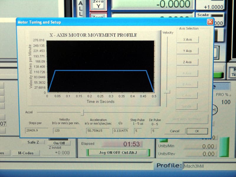

Do you still have more travel left on the damping trim pot? If so, and you have a good scope display showing critical damping, you can try for more performance. Go to the Mach3 motor tuning and you can increase either acceleration or maximum motor speed. Acceleration is the more valuable of the two to increase, but it is also the most expensive. In other words you will likely be able to get more top end than acceleration from your servos.

I got my mill X and Y axes up to 50 in/sec/sec or 0.13g's acceleration with the o-scope. Without it, I could only get to maybe 40'ish by ear. Z has the heavy mill head, so about half this much acceleration is available...
