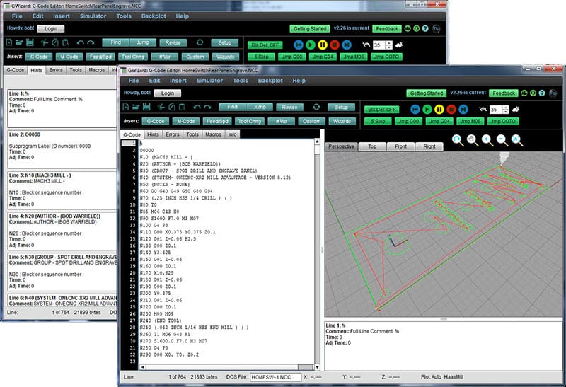

Here's a typical example, our own viewer software, which we call G-Wizard Editor:

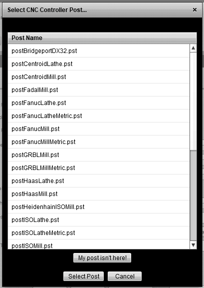

1. Support for G-Code Dialects
Can you run any g-code on any cnc machine?
No, of course not! CNC machines have their own dialects. In many cases they are similar, but the details matter a lot.
Unfortunately, the vast majority of nc viewers don't have any way to adjust for particular g-code dialects. They simply assume a fairly generic dialect and ignore anything they don't understand.
Of course if you were using the g-code simulator to find bugs in g-code files before running on the machine, there are many that can slip by such generic software programs. A real g-code simulation has to simulate your machine's g-code, not some other imaginary machine's!
Here is our G-Wizard software's post selection showing a few of the available posts:

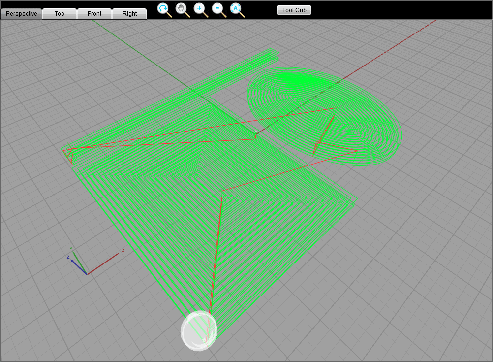

2. Real 3D Backplot
A graphical backplot is the first thing you'll notice and the feature you'll use the most on your nc viewer. Its a visual view of the tool path and really the epitome of g code simulation. Make sure the program you select has a good one.
Here's a closeup of G-Wizard Editor's backplot view showing the tool path in green and rapids moves in red:
Notice the different views and the icons to adjust and position the backplot as needed so you can really focus on what part of the tool path you're interested in. The best g-code simulators have that.

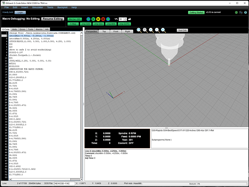

3. G-Code Debugger with Single Step and More
This is critical to understanding what the g-code is doing so you can find and fix bugs or improve the g-code. Single stepping is the ability to have one g-code executed each time you press a button or click with your mouse.
The more information you can get about the state of the simulated machine the better. At the least you should be getting the XYZ position and the spindle speed. Also handy would be seeing the values of g-code variables and the modes that have been set.
Any features that can allow you to get through uninteresting g-code more quickly than single stepping are also handy time savers for this kind of work.
Here is G-WIzard's Debugger set up for single stepping:
Note the single step controls on the toolbar give a lot of options to move more quickly than just a single step. You can even move to the next tool change or rapids. Or you can put a dwell (G04) into the code and go to it with a single click. Also note the information displayed below the backplot tells you the modes and other handy info about the state of the simulated machine.

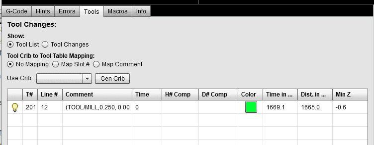

6. Tool Management and Support
Having the correct tools installed on the machine and called up is important. Being able to view the tools and information about how the program uses each one can be very helpful.
Here is G-WIzard Editor's tool view:
You have the ability to show both the overall list as well as every tool change in the program. You can double click to go to the change. You can change the backplot color of a particular tool to make it stand out. You can turn tool visibility in the backplot on our off so you can see tools of interest more clearly. And you can associate tools with Tool Crib entries that have a full definition of the tool for reference.

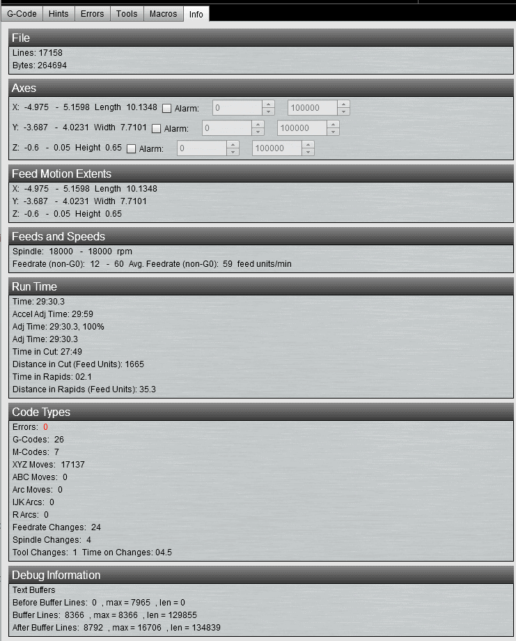

8. G-Code Info and Reporting
A line of g-code can do a lot. What does your nc viewer tell you about that line?
A cheaper software viewer might not give you anything but the g-code itself and the backplot. There's so much more possible that's very handy to have such as a simple English translation of what the line is doing and additional information like what the radius and center of any arc are.
How about making clear the effect of acceleration on nc file execution time? On most machines, a lot of the g-code never gets to full commanded speed because of acceleration effects.
Here is G-Wizard's Info tab which gives you tons of summary information about the nc file:
Another very useful feature is having the ability to generate reports with this information. Getting that all out of the viewer software and into a general format like a spreadsheet opens up a lot of possibilities for your analysis and massaging of the nc file.
