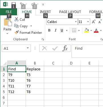

Check out the new “File” button right next to “Close”…
The “File” button will prompt you for a CSV (spreadsheet) file that contains a series of Find/Replace values, and it will execute them all on the current file. The file format is simplicity:
One column of “Find” values and one matching column of “Replace” values…
One column of “Find” values and one matching column of “Replace” values is all you need. This feature was motivated by a customer (thanks Clyde!) who had been handed a whole bunch of gcode files that needed their tool numbers changed. I suspect these kinds of wholesale changes are not that uncommon, so this feature will give you a way to automate them and save some wear and tear at the keyboard and mouse.
