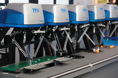

According to Wikipedia, a delta robot is a parallel arm robot invented in the early 1980s. The delta format was developed to manipulate light and small objects at high speeds. Here us a photo of a row of delta robots picking parts:

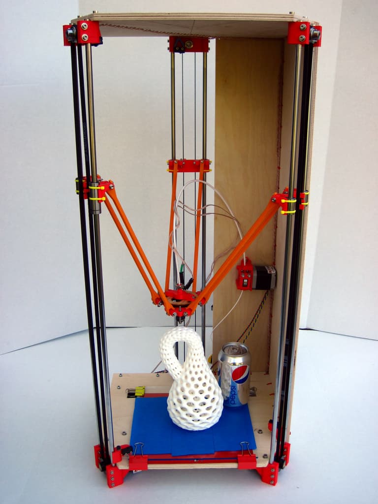

In 2012, Johann Rocholl revealed his Rostock Delta Robot 3D printer to the Open Source RepRap community. I believe this was the first delta printer capable of printing. The Rostock was derived from a 2010 project, the Helium Frog Delta Robot, which was an experimental platform that could draw but not print. The heated nozzle, or hot end, is mounted on the delta head but to keep moving mass low, the extruder mechanism is mounted on the rigid structure and connected to the hot end with a Bowden tube as described in my last post.
The Rostock had lofty goals:
- a large build volume - 200x200x400mm (8x8x16")
- 800 mm/s positioning speed in all 3 directions
- 30 steps.mm positioning accuracy in all 3 directions
- simplicity
- hardware costs less than $500
All three axes of movement on a delta printer are identical. This reduces the number of unique parts and makes for simpler construction. Cartesian printers typically have three different positional mechanics for each of the axes with differing position speeds and accuracy on these axes.

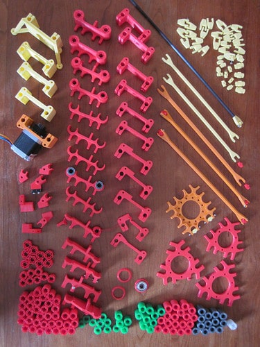

The folks at SeeMeCNC worked with Johann last year to design and produce the very cool Rostock MAX delta printer kit. I own and built a Rostock MAX earlier this year and it is an amazing thing to watch print and has a massive 1300 cu-in build volume with a 11" diameter build surface and 14-3/4" height.

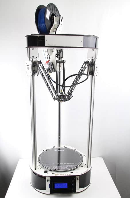

This is actually the SeeMeCNC Rostock MAX V2 kit. CNCCookbook ordered one of these...
