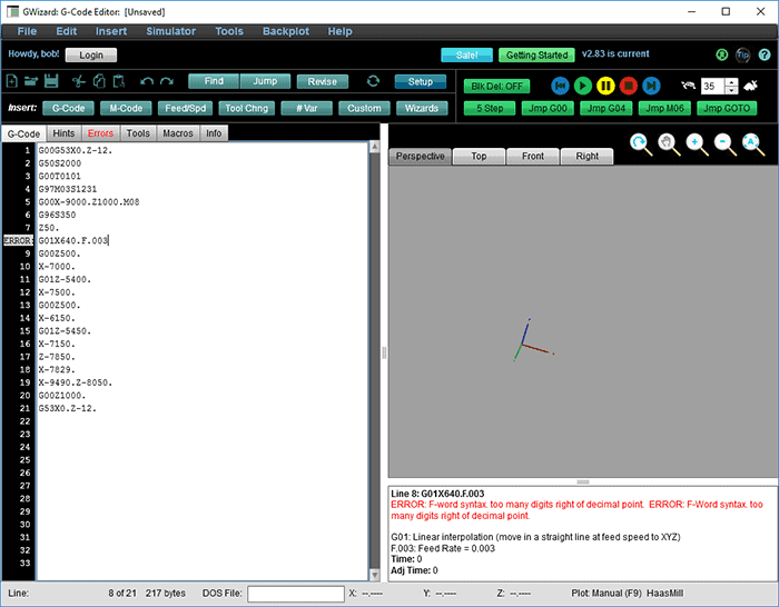

Once you make that change and save it, a bunch of errors crop up:
SyWiz G-Code Editor interface screenshot.
Now you can see where the errors are.

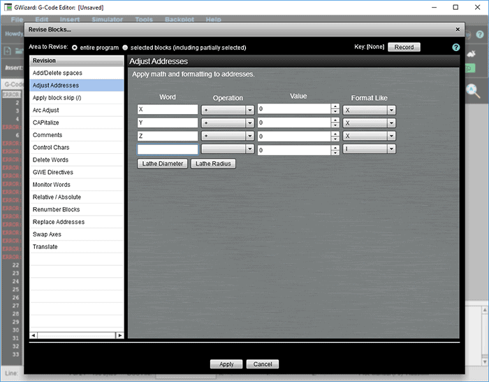

Step 2 - Use a Revision to fix the problems
GW Editor has a feature called "Revisions" that does powerful editing on your G-code.  It's syntax-aware and often far more powerful than a simple Find and Replace (GWE does that too).
In this case, I will use a Revision called "Adjust Addresses" to make the change:
A screenshot of a computer program with multiple windows open, displaying various menus and toolbars for machining or metal fabrication.
This Revision lets us specify a mathematical and a formatting option on a word-by-word basis.  In this case, I am updating the X, Y, and Z words.  I don't want to change the values, I just want them to fit the new format I set up with the post change.  So, I will simply add zero to the word. And that's what you see it set up to do.

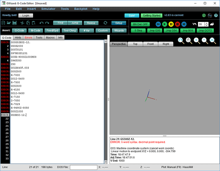

I run the Revision and suddenly most of my problems are gone!
A computer program screenshot with menu bar, grid layout, and toolbars.
It complains there are too many digits after the "F" word, but we can either ignore that or update that in the post too if desired.
