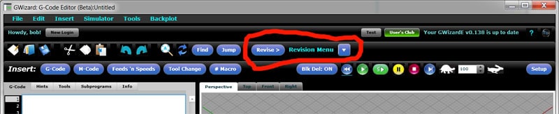

You can also access Revisions from the Tool Bar:
Revisions Tool Bar
Run the last Revision again with the same options by clicking the “Revise” button. The message to the right tells you which Revision you’re getting. If you haven’t run any yet, it just brings up the Revision Tool. The down arrow also brings up the Revision Tool so you can change an option or pick a different Revision.

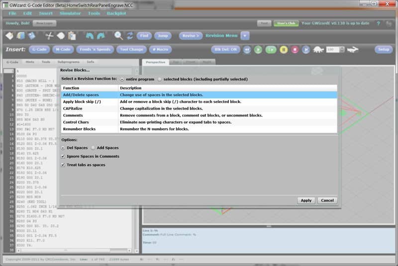

Add/Delete Spaces
Purpose:
Like the name says, “Add/Delete Spaces” is used to add or remove spaces. Why would you want to remove spaces? Largely to reduce program size for machines with limited controller memory. Why add them back? To make your programs easier to read.
If you have to do a lot of work with a machine that needs to remove spaces, consider creating a File Open Auto-Revision to add spaces and a File Save Auto-Revision to remove the spaces. That way, whenever you have to edit a file, it will have spaces, and whenever you save to send it to your machine, it will create a smaller file.
Options:
Revision Options for Add / Delete Spaces
You have a choice to Del(ete) or Add Spaces. Spaces are added between each the argument for each word (letter), but not between the word and the argument. For example:
Before Revision: X0Y0Z0
After Revision:    X0 Y0 Z0
You have the option to ignore spaces in Comments. This keeps the comments looking more like conversational language.
You have the option to treat tabs as spaces, which means tabs will be deleted when you run Del(ete) Spaces.

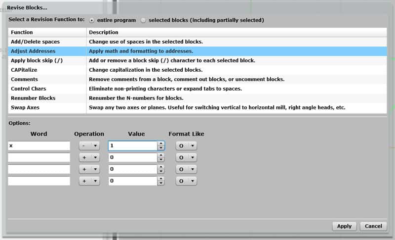

Adjust Addresses
The Adjust Addresses command makes it easy to apply math and formatting to addresses:
Adjust Addresses in G-Code
Adjust Addresses revision makes it easy to apply math and formatting to addresses…
It lets you modify the value of up to 4 different words. Enter the word, the operation, a value, and which word you want to format like. The example in the screen shot will subtract 1 from every “X” word and format the result as you would an “O” word.

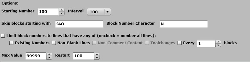

Renumber Blocks
Purpose:
Sequence numbers (“N” numbers) are a nuisance to keep straight in a g-code program. The Renumber Blocks Revision is useful tool for automatically renumbering blocks. It has a lot of smarts for exactly what to renumber and how. Renumber Blocks understands how to adjust number references. For example, when you use a G71 rough turning canned cycle it has P and Q words that refer to the first and last block number defining the profile. If we renumber, we have to adjust the P and Q words to whatever their original block numbers got changed to.
Options:
Starting Number: This is the first Block Number that will be used.
Interval: The amount to increase consecutive Block Numbers. Choices are 1, 2, 5, 10, 20, 100, and 1000.
Skip Blocks Starting With: Don’t renumber blocks whose first printing character is one of these characters.
Block Number Character: Block Numbers are this word (character) followed by the number.
Limit Block Numbers To: If this option is turned on, only lines that fit one of the checked options below will be numbered. Numbers are removed from lines that don’t fit. Options for which blocks to number:
Existing Numbers: Number lines that have an existing number. Ignore non-numbered lines unless they fit one of the other checked options.
Non-Blank Lines: Don’t number lines that are blank.
Non-Comment Content: Don’t number lines that have nothing but comments on them.
Toolchanges: Numbers lines that have toolchanges.
Every <n> Blocks: Number every nth block.
Max Value: The largest Block Number supported by your controller. This number will be initialized from your post but can be overridden if you prefer.
Restart: After the largest block number has been used, numbering starts over again with this value.

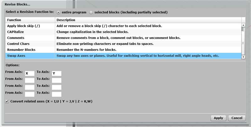

Swap Axes (For Right Angle Heads, Horizontal Mills, and Such)
I ran across a request over on CNCZone for the ability to go through a g-code program and swap the axes. Apparently this is useful for writing programs for right angle heads or in some cases for converting a program from a vertical to a horizontal mill. I did a little research and came across two threads over on Practical Machinist that wanted the capability for the same reason. Since it’s not hard to do and seemed to be something useful, I put together the capability to do this in G-Wizard G-Code Editor. It looks like this:
Swap Axes for Right Angle Head
The Swap Axes Revision will swap up to 4 axes and automatically convert the related axes…
With Swap Axes (under the Tools Revisions menu), you can swap up to 4 axes if you need to. Just tell it the “from” letter and the “to” letter. These is also the option to automatically swap any related axes. For example, if you are swapping X to Y, you probably want to swap I to J and U to V (Fanucs lets you use UVW as relative versions of XYZ so you needn’t keep switching modes). One click saves you some time. This related axes option is not something I’ve seen in other editors, but it sure makes sense if you had to do this sort of thing very much. Note that the swap is one way unless you specify both directions. So if you truly want to swap X and Y, you would put X to Y as one line and Y to X as the other.
The related threads I linked to had some good tips on how to go about this type of programming. In particular the first tip also mentions that at least for one machinist, they had to switch G02 for G02. I thought about adding a checkbox to automatically do that as well, but hadn’t seen any other examples where it was necessary so left well enough alone. If someone who does a lot of right angle head programming wants to suggest further additions to the function, drop me a note.
BTW, it does kind of bake your noodle a little bit to think about programming a right angle head, but it isn’t so bad if you just think of doing it in the normal XY plane and then use a capability like this swapping to move it to another plane. Read through all the links I gave before you attempt it, there’s some good advice in them.
