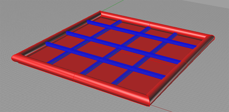

The table for the machine has a frame constructed of 3" diameter 1/2" wall thickness DOM steel tubing. The table surface is 48" x 48", but the technique could be scaled to a larger or smaller size. A 1/2" thick steel plate under the DOM serves as the bottom, and a framework of 1" steel rods is welded inside on a 1′ x 1′ grid to act as rebar-like strengtheners. I am postulating that all DOM tubing would be filled with the EG material for further dampening and stiffening. Here is a view of the pour frame:
3" DOM Tubing and 1" "Re-Bar" Pour Frame...
I call it the "pour frame" because it will serve not only as a frame to hold the EG, but also as the mold into which the EG will be poured.

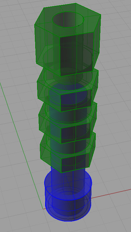

Having completed the welding of the pour frame, the next step is to install the insert grid. The insert grid consists of pieces made of steel that have a threaded 5/16" hole at the top and a 7/16" cap screw threaded into the bottom. I have drawn them as constructed of 3/4" hex stock, but they could as easily have been round stock. I feel the hex will lock into the matrix better. To augment that and help prevent pullout, I have specified that grooves 1/4" wide will be turned into the stock:
The insert assembly consists of the hex stock insert and a 7/16" socket head cap screw...
Aesthetics and Stress Riser Note: If you care how things look, it may make sense to turn the top 1/8" or so of the hex round. The hexes will wind up in different orientations as they are leveled, and if the top is round this won't be obvious once the epoxy is poured. Only the round portion will be visible at the top. While I'm on this topic, long time CNCZone contributor Geof has suggested eliminating the sharp edge from the inserts to avoid stress risers. That should be easy to do during the CNC operation making them. If on a manual lathe, I would think a form tool for the lock in grooves might be a good way to round off the edges while cutting the grooves.
We'll be installing the insert assemblies on a 2" grid within our pour frame. The 2" grid is a pretty common measurement I see for tooling plates in the CNC world. It gives you a close enough grid to bolt just about anything down properly on the table. We'll be using these inserts with their 5/16" holes for workholding as well as for mounting the linear slide system that will be used for the gantry.
One thought on these insert assemblies before I go further. Consider the issue of wear and tear on them. It would be reasonable to consider a couple of different ways to manage this. First, we could use some sort of hardened steel for the assemblies, which would help tremendously. Second, we can use replaceable threaded inserts that are commercially available for the purpose from outfits like Carr-Lane. Whichever approach is taken it also makes sense to keep flush bolts in the holes when they are not in use so they don't become a repository for old chips. I would suggest putting these flush covers in place before any epoxy gets poured!

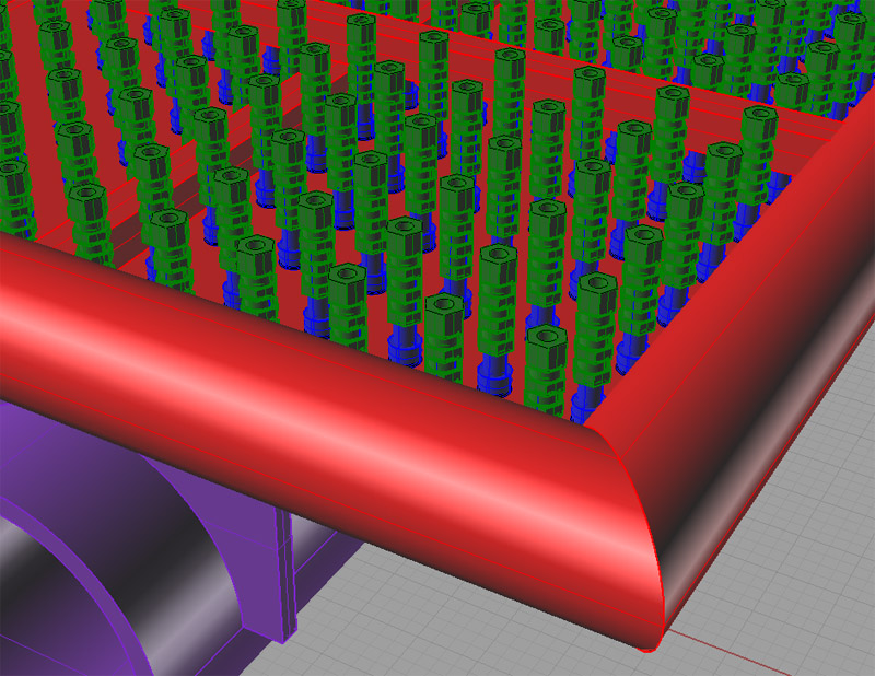

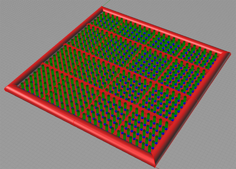

These pieces are installed by tack welding the SHCS screws to the 1/2" plate that is the bottom of the pour frame. We would make sure that each one is as close to vertical as possible during the installation process. When finished we now have a grid of these inserts welded into our pour frame:
Pour frame with 576 hex inserts installed...
Close up on the inserts...
Fabrication Note: It's going to be darned tight getting your welding torch down into that grid with only 2" on each side and 3" deep! I recommend tack welding the insert assemblies to the 1/2" plate before the surrounding DOM tubing and 1" square "re-bar" is installed. At least then you can work from the middle out and access it from the edges to weld the inserts.

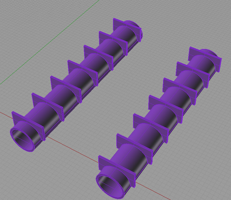

Support Sub-Frame
When we pour the Epoxy Granite mixture into the pour frame, the result is going to be quite heavy. That's a good thing, but there may not be enough beef in the assembly to maintain precision. Accordingly, I have sketched a support subframe that consists of further DOM tubing and weldment construction. It is made of 8" diameter 0.500" wall thickness DOM tubing and 1/2" steel plate:
8" DOM 0.500" Wall Tubing Sub-Frame...
The sub-frame very much follows Bamberg's approach for this sort of thing. It would probably be better with a cross-member to provide an "H" shape, but FEA analysis is needed to really prove out this whole design anyway. I would fill the 8" DOM with the EG mixture and a bundle of rebars spaced into a hex pattern and running the length of the tubing for additional dampening and strength.

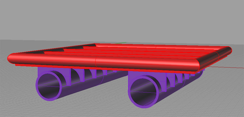

Here it is with the pour table and inserts back in place:
The next step is to level the inserts.

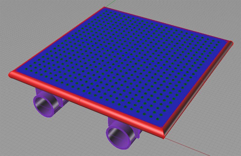

Time to Pour the Epoxy-Granite!
Let's review. We have created a pour frame and anchored it atop a solid sub-frame. The 576 inserts within it have been precisely aligned so that they form a level plane of points accurate to within 0.001" or better (preferably better!). We are now ready to pour the epoxy-granite mix and create the table!

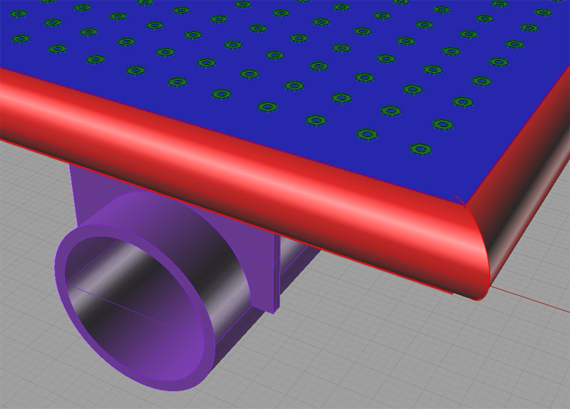

It should be a thing of beauty once it cures:
Epoxy Granite Table with Inserts...
Now given what has been written about this miraculous Epoxy-Granite composite material, we should just have created an extremely rigid, extremely well damped, and accurate to 0.001" table on which to build the rest of our gantry mill. The 5/16" inserts provide a convenient place to bolt the railing system needed to carry the gantry, for example.
