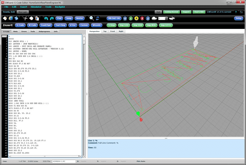

What CutViewer does
- 3D backplot of your toolpath, with rapids, feed moves and arcs in different colors. It handles arcs in all three planes, helical arcs and drilling cycles.
- Simulation: play the program at any speed, drag to any point, or click a line or the toolpath to see exactly where the tool is.
- Pre-flight checks for problems that stop a control or crash a machine: a feed move with no feed rate, an arc whose end point isn't on the arc, cutting with the spindle off, a rapid below Z0 into uncut material, and missing G20/G21 units.
- Job stats: part size and extents, estimated run time, cutting and rapid distance, feed and spindle ranges, and the tools used.
- Editor: edit the g-code with syntax highlighting, watch the toolpath update, and save the result.

- Home switch panel engraving. CutViewer flags that it never sets G20, though it's an inch program.
