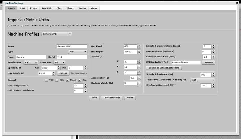

Basics
The Basics tab is all about setting the units, as well as selecting and defining machine profiles. Let's talk units first. When you change the units, it changes the units for the controls in the editor and it changes the grid but it does not change how the simulator interprets coordinate values in g-code. To change the coordinate value units, use G20 (inches) or G21 (mm). You can either use these in your program, or you can use them in the Setup G-Code under the post tab. So, for example, if your CNC comes up by default expecting mm, put a G21 in your startup g-code.
Always remember, G20 and G21 don't do unit conversion, they merely change how the numbers are interpreted. With G20, X0Y1 refers to X = 0 inches and Y = 1 inch. After a G21, X0Y1 refers to X = 0 mm and Y = 1 mm.
When we say it changes the units for the controls in the editor, that means it changes the units for the XYZ coordinate display down on the status bar, for the Info tab, for the Simulator information that appears below the backplot, and so on.
You can download a pre-defined CNC Controller configuration from CNCCookbook to save the effort of defining all the Post parameters. To access a controller, first click "Download Latest Controllers". This brings all the controller files (they're like Posts on a CAM program) onto your machine. Then you can use the "Browse" button next to the CNC Controller field on the Machine Profile to select one.
GWE will automatically download the latest posts the first time you start up each new release. But, it won't update the post that you are actually using, because that would overwrite any changes you may have made. So, if you want to take advantage of newly downloaded posts, you'll have to Browse and select them manually.
For more on machine profiles, check out the G-Wizard Calculator Setup documentation.

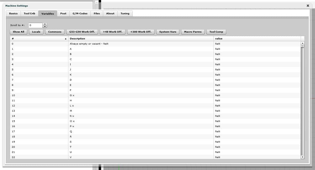

Variables
The Variables tab lets you access the internal variables of your simulated CNC machine. These are variables accessible via programs using a "#" and a number and are primarily of interest to programmers writing macros (sometimes called "Parameterized Programming"). But even if you're not writing macros, you may need to access them to set up your work offsets or other offsets so that your g-code program will run properly.
Here is the Variables Tab:
The Variables Tab...
As you can see, the Variables Tab consists of a scrolling list of all the variables together with a set of controls at the top to help you quickly find the variable you're looking for. If you know its number, you can type that into the "Scroll to #" box and get there immediately. If you only know the general category of the variable, you can filter the list using the following buttons:
Locals: These are the so-called Local variables that run from #1 - #33. They're only used within macros to hold intermediate results (hence they are "local" to the macro). When power is turned off, local variables go back to a null value. See your controller manual for more on Local Variables.
Commons: Common variables run from #100 - #199 and #500 - #999. Common variables can be shared among your different macro programs, hence they are "Common. Their status when power is turned of is controlled by the "Volatility" setting under the "Post" tab. See your controller manual for more on Common Variables.
G53-G59 Work Off.: Work offsets are a powerful tool for letting the same program work on multiple parts (as well as many other users). The offsets for G53-G59 are accessible via this button. See your controller manual for more on Work Offsets.
+48 Work Off.: Some controllers add another 48 work offsets beyond G53-G59
+300 Work Off.: And some controllers have still more work offsets, another 300!
System Vars: System variables can be used to read and write a variety of information when programming such as the machine's current position or tool compensation values. See your controller manual for more on System Variables.
Macro Parms: Macro parameters run from #6050 to #6089 and offer a way of passing parameters to your macro programs. See your controller manual for more on writing macro programs.
**Tool Comp:**These variables hold the offset values for Tool Length and Tool Diameter Wear compensation. See the Tool Data Managment page for more details.
Note: At the moment, there's not much you can customize on the Variables Tab.
