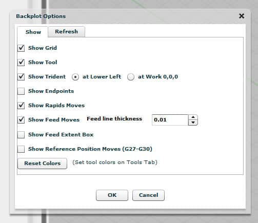

Before we get into Simulator Mode, let's describe the Backplot Options that are available. They're accessed from the Backplot menu, and there are two tabs on the popup. The first is for the "Show" options that control which elements are displayed in the Backplot:
Backplot Show Options...
You have the ability to control visibility of the following by turning the check boxes on or off:
- Grid: The grid that provides a reference may be turned on or off.
- Tool: The simulated 3D tool and holder may be turned on or off.
- Trident: The trident that shows which direction X, Y, and Z grow larger (positive) may be turned on or off, and it can be displayed in the lower left of the backplot or always at work 0, 0, 0.
- Endpoints: This options displays the endpoints of each segment with a marker so it is easier to see where segments begin or end.
- Rapids Moves: This option toggles whether G0 moves are shown or not.
- Feed Moves: This option toggles whether non-G0 moves are displayed, and if so, controls the line weight used to draw them.
- Feed Extent Box: GWE will show an extent box when you attempt to rotate or pan a complex backplot. This option controls whether the extent box should be shown all the time.
- Reference Position Moves: This option controls whether reference moves, triggered by G27 to g30, will be plotted.

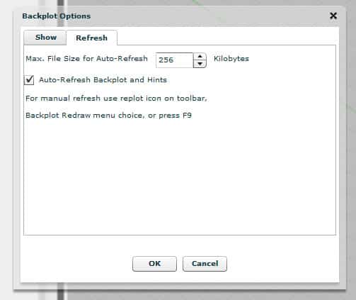

The Refresh tab contains the options that control how often the Backplot is replotted:
Backplot Refresh Options...
You can set the maximum file size that will auto-refresh after any change. Files larger than this size require manual refresh by pressing the refresh button on the Toolbar or by menu pick. You can also press the F9 key to cause a refresh. The checkbox allows you to turn off auto-refresh even for files smaller than the maximum size.

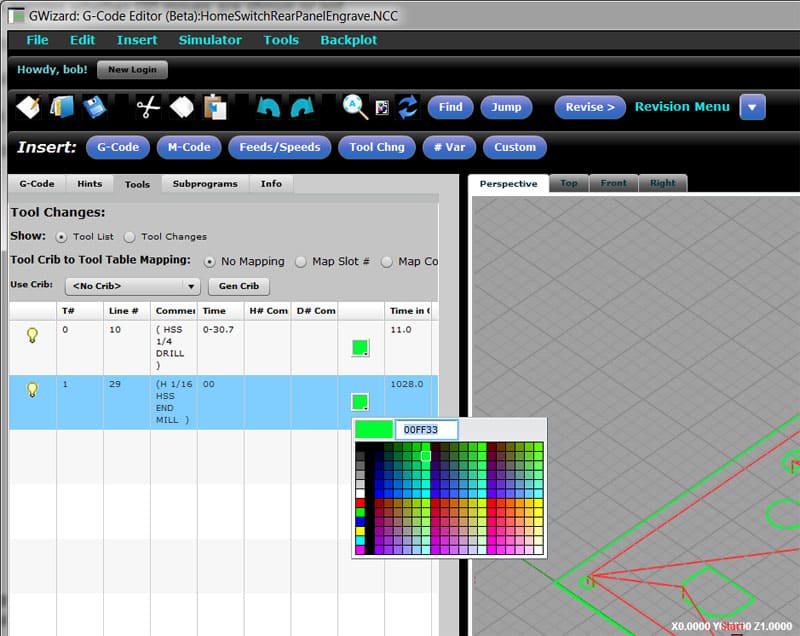

Options for Backplotting Individual Tools
The visibility and color of backplot for individual tools may be controlled via the Tool tab:
The visibility and color of individual tools may be controlled from the Tools tab...

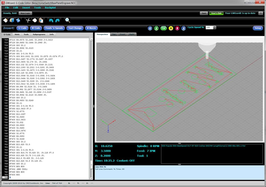

Starting CNC Simulator Mode
The easiest way to transition from normal editing mode to CNC Simulator Mode is to press the rewind button on the Simulator Control Buttons on the toolbar:
Simulator Control Buttons...
In Edit Mode, G-Wizard places a subtle underline that appears by the rewind to remind you this is how to start CNC Simulator Mode:
Note the underline of the Rewind button to remind you how to start CNC Simulator Mode...
Take a minute to run your mouse cursor over each button. There is a tool tip that pops up to describe the button's function:

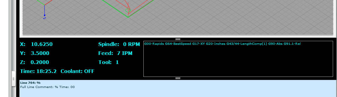

GWE provides an instrument cluster directly under the backplot that provides information about what the g-code is doing in addition to what you see on the backplot:
The Simulator Instrument Cluster...
This is similar to the information provided by your machine's controller. You get to see the coordinates on the various axes, as well as the spindle's status, the feedrate, the current tool, how long the program is predicted to take to execute to this point, and the status of coolant. In addition, you will see information about what modes are active. For example, in the screen shot above, we can see several:
- G00: The motion mode is G00, so the machine will move at rapids speed when commanded to move.
- G64: Another aspect of the motion mode is whether the machine moves at G64 "Best Speed" or G60 "Exact Stop".
- G17: The currently selected plane for arcs and canned cycles is G17, the XY plane.
- G20: The currently selected units are Inches.
- etc.

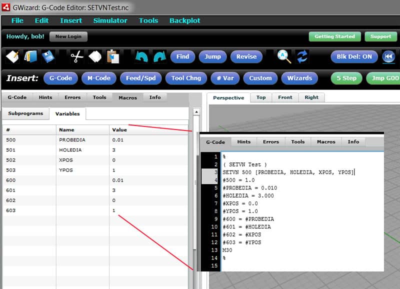

So, I decided to add a new macro variable tab to the G-Wizard Editor to make it easier to keep up with what’s going on. It looks like this:
The inset shows the g-code that goes with that Variable list…
You access the Variables list as a sub-tab under “Macros”, which used to be called “Subprograms” back before we had a “Variables” tab. In the list you will find every single variable your program accesses together with the symbolic name (if any) and the last value the variable had when the simulator ran. Now you have an easy way to find out what variables your programs access. You could even use this tab to help document a g-code program if you need to.
While I’m on the subject of macro variables, I wanted to revisit a couple of items. First, GW Editor supports the full Fanuc “SETVN” syntax, which you see in action in the screen shot. SETVN can be used to give variables friendlier names. But, there’s more (and no, I’m not talking about steak knives here!):
G-Wizard Editor Let’s You Name Your Variables Even If Your Controller Doesn’t
This is a very cool feature, so let me just say it a second time:
You can give your variables names even if your controller doesn’t allow that syntax.
