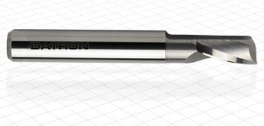

Why use a single flute end mill? Because they work better in some cases, that’s why!
BTW, sometimes these beasts are called o flute end mills or 1 flute end mills.
There are a lot of strange beasts out there in the cutting tool world, and a lot of physics that are not obvious. For example, many machinists will know that more flutes means more productivity, but that certain materials, like aluminum, require fewer flutes–usually a two or three flute end mill. If that’s the case, when would it ever make sense to use single flute end mills? Is there a time when the least number of flutes possible is a good idea?
In a word, “Yes!” Let’s talk about why.
The reason we use fewer flutes in some materials has to do with the behavior of chips in those materials. Simply put, aluminum creates bigger chips, all other things being equal. This has to do with the way the material curls as well as other factors.
The space created by the flutes of the endmill is where the chips have to go as they’re being cut. If there is not enough space relative to the volume of the chips, you’re going to have problems and may wind up with a broken cutter. Chip welding is one type of problem where the chips weld on to the cutting edge making it stop cutting.
Chip welding in aluminum…
To minimize these chip evacuation problems, we typically dial back the number of flutes for aluminum because it creates a larger volume of flute space to carry away the oversized chips. Single flute end mills have the best chip evacuation possible. The chip large flute valley on single flute end mills is what makes it so.

Now let’s take a CNC Router example. Say it’s got a spindle capable of 24,000 rpm, but it will go no slower than 12,000 rpm. When cutting aluminum, the first thing we discover is we need carbide to run at those surface speeds–preferably a good coating is needed to up the limit even more. As we begin working through the feeds and speeds (hopefully using G-Wizard Calculator!), we discover we’re going to need some pretty high feedrates at those rpms too. For a 1/4″ endmill, it wants to run at 24000 rpm and a feedrate of about 255 IPM. Now depending on the machine, we may have discovered a problem. What do we do if our machine can’t feed that fast?
The answer is to use a single flute endmill because it halves the necessary feedrates without rubbing. So there is one case where it helps, when the machine just can’t feed fast enough to keep up with what the spindle is putting out and maintain adequate chip loads.
Here is the other case: Whenever the extra chip clearance is of benefit.
There are lots of chip clearance challenging scenarios out there:
– You’re cutting really gummy cast aluminum plate. Definitely go to 2 flutes instead of 3, but you may find you have to go all the way down to a single flute.
– Micro-cutters have terrible geometry compared to larger cutters, it’s just life in the world they live in. You can only make the cutting edge so sharp, and at micro-scale it isn’t sharp enough. So the flutes are beating their way through the material like a cold chisel and 5 pound sledge instead of cleanly slicing. The tendency to chip welding is much higher and chip clearance is problematic when micromachining. Switch to single flute. Datron has been recommending this for roughing for a long time and even makes special singles flutes with a geometry allowing them to be balanced for high rpms.
– You’ve got to cut a brutally deep slot or small deep pocket and it is extremely hard to pull the chips up out of the hole. They are just hanging out down there clogging up the works. Ideally, you’d try through spindle coolant, but failing that, give single flute endmills a chance.
– You’re doing deep relief 3D profiling where the cutter is dropping into a lot of narrow spaces without much clearance.
Okay, that’s two good cases for single flute end mills, and we’ll end on a third: Some materials just come out better with single flutes. Typically, these are softer materials that are easily scratched. Making it easier for chips to get out of the way so they don’t go back in and scratch things up is a good idea.
Many plastics fall into this category, although a two flute will polish some plastics. A lot of wood products will also benefit from a single flute cutter. Soft woods and MDF comes to mind.
Any cutting of stacked sheets can sometimes benefit from a single flute cutter as well. These differences are typically not very profound, and usually will only come to light at higher rpms.
There you have it. A bunch of information to help you decide when it makes sense to use a single flute cutter.
On my visit with Datron, I learned they recommend single flute endmills for many applications. Fewer flutes means less chip recutting and the finishes just come out better. I walked away from the demo with a mirror finish mold part straight off the machine that sure made me a believer!
