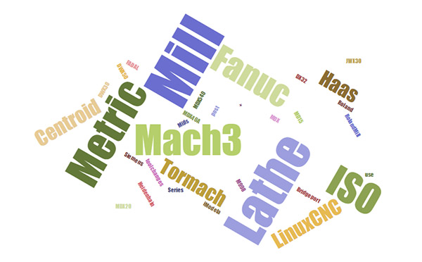

There Are Many Dialects of G-Code
Some wag once joked that the great thing about standards is there are so many to choose from.
There are many G-Code standards and dialect. While much of it remains the same from controller to controller (setting aside alternatives to G-Code from things like Mazatrol, Heidenhain’s Conversational CNC language, and others), there are important details and defaults you need to be aware of to understand the particular dialect of g-code your controller needs to be happy.
In terms of sheer numbers of users, the Fanuc dialects of G-Code are probably the most common among professionals and Mach3 among hobbyists. This is not to say they are better than other G-Code dialects, just that they are more common and so if you’re going to talk to other machinists or move around from job to job and machine to machine, it may be helpful if you’re familiar with those dialects and how they differ if your machine doesn’t use one of these two controllers.
For more details on the relative popularity of different dialects, check out our CNC Controller Survey.
G-Code has an extremely long history. The first attempts at standardizing it came out of the Electronics Industry Association’s RS-274 standard which has evolved to NIST’s RS-274NGC standard. The original EIA standards work was begun in the 1960’s but the first standard wasn’t released until 1980. Even though there are now standards (ISO has one too that is nearly the same as RS-274), it isn’t clear how many controllers out there are purely standards based. Indeed, many controls will claim to be some standard or other, but when you look closely at the details they’re pretty non-standard.

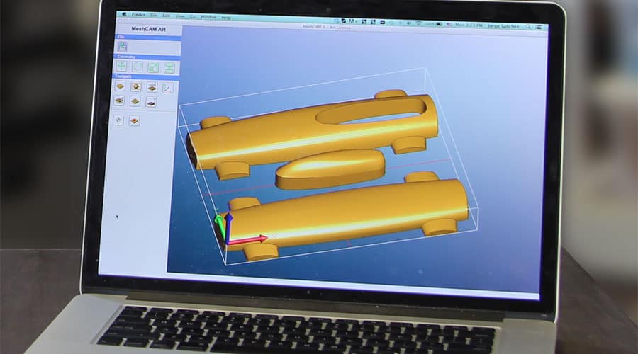

CAM Software
MeshCAM: The world’s easiest CAM software…
We talked a bit about CAM Software already.  It’s used to convert CAD drawings (or 3D Models from CAD) into g-code.  3D Printers use software called “Slicers” that does the same job.
Since this Guide is largely about programming in g-code, we won’t spend a lot of time talking about CAM.  But, if you want a quick run through of the basics, try our article, “Secrets of CAM for Beginners.”  It’s got a lot of great info and even walks you through making the same part using two different CAM packages.

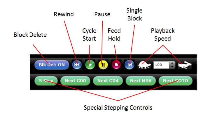

G-Code Simulators, Debuggers, Backplotters, and Viewers
cnc g-code simulator
G-Wizard Editor’s Macro Debugger control panel…
While most G-Code Editors include a built-in Simulator, they’re not all of equal power.  In addition, you can buy Simulators that don’t include an Editor.  I’m not rule sure what the value of that might be, but they’re out there.
Simulators may also be called Debuggers, Backplotters or Viewers.  Their role is the same.  They simulate the execution of your g-code in the g-code dialect you’ve selected.  You can see the graphical backplot of the toolpath in the G-Wizard Editor screen shot above.
You can tell at a glance from a backplot exactly what moves the tool will make when the program is run.  A very high quality simulator (like the one in our G-Wizard Editor), has a more capabilities than just a backplot:
  • Your CNC Machine has what are called alarms.  Certain things will trigger an alarm even though the backplot looks fine.  A good simulator has alarms too so you can check your program and fix all the alarms before they show up on the machine.
  • Macro Debugger.  This is the ability to test and thoroughly understand g-code macros.  Macros are the ultimate in CNC Programming power and flexibility, but they can be quite complex to create, understand, and debug.  Hence a Macro Debugger is a valuable assistant when dealing with them.
  • A Post Processor, just like your CAM Software uses.  Most simulators don’t have a post.  They make a lot of assumptions, which means they can’t accurately identify problems relating to g-code dialect.  You want a simulator that has a post.
G-Wizard Editor has all 3 capabilities and more.

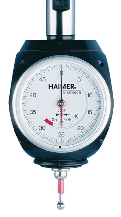

And here is a demonstration of a Haimer 3D Taster:
Haimer 3D Taster…
A probe can be the ultimate in convenience for doing these kinds of Zeroing operations. Here is a Renishaw probe setting up work offsets:
Renishaw probe setting up work offsets on a VMC…
Each of these tools is similar in purpose, just with increasing capability, automation, and expense. There are a wide variety of other tools available for precisely locating features on your parts and workpieces. Some are more specialized, such as the Blake Coaxial Indicator, which is used to locate bore centers.
