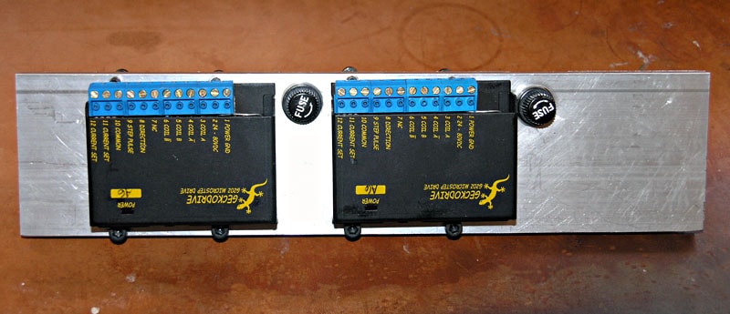

Gecko Drive Heatsink Mounts
I used a piece of extruded aluminum heatsink material from eBay to create a tray for the Geckos and their fuses:
A little light milling machine work was all it took. I need to decide whether to mount the tray vertically, which will save space, or flat on spacers. I’ll have to see how the chassis lays out when I get the remaining components together.
