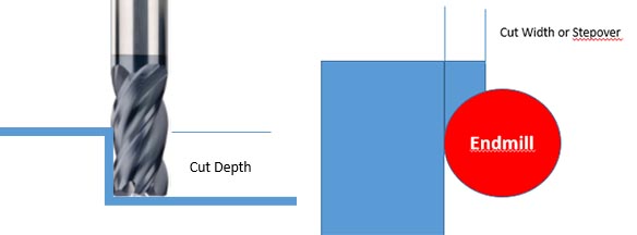

Let’s start by defining the terms “Depth of Cut” and “Cut Width” (also called “Stepover”). Since a picture is worth a thousand words:
Depth of Cut is the length of the side of the flutes that are actually cutting. So, if you’re doing a pocket in several steps or layers, it is the thickness of the current layer you’re cutting and not the total depth of the pocket. Depth of Cut is also referred to as Axial Depth of Cut.
Cut Width, also called Stepover, is the total thickness of the cut when viewing the cutting tool from above. It can be no more than 100% of the cutter’s diameter. Stepover is also referred to as Radial Depth of Cut.

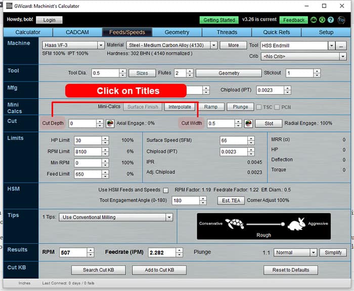

Optimizing Depth of Cut and Cut Width Using G-Wizard’s Cut Optimizer
We introduced the Cut Optimizer some time ago and it has been an extremely popular part of G-Wizard. To this day, only G-Wizard has a Cut Optimizer.
The Cut Optimizer is easy to use, and it lets you optimize one of the two variables (Depth of Cut or Cut Width) while you hold the other one constant. For example, suppose you need to machine a slot that is 1″ deep with a cutter that is the diameter of the slot. You will be holding Cut Width constant–it’s the diameter of the cutter. But Depth of Cut is the variable to be optimized. What the Cut Optimizer does is to calculate the deepest cut that can be taken without creating excessive tool deflection.
Or take an opposite example. You’re profiling a wall and you’d like to do it in a single pass instead of having to step down for multiple passes. You want to do this because the wall finish will look prettier without having the steps visible and because it spreads the wear over a longer flute length, which means your tool will last longer. In that case, Depth of Cut is the constant and the Cut Width is what you’d like to optimize.
Cut Optimizer is good with both kinds of problem and we show you exactly how it works in our G-Wizard University Video:
Cut Optimizer in action…
G-Wizard University provides short videos on specific topics that make it easier to learn our G-Wizard Software.
Optimizing the Depth of Cut or Stepover to keep Tool Deflection under control is super easy. Just click the title of the one you want to optimize and it’s done:
Just click the label of the variable to optimize (Depth or Width) and it’s done!
